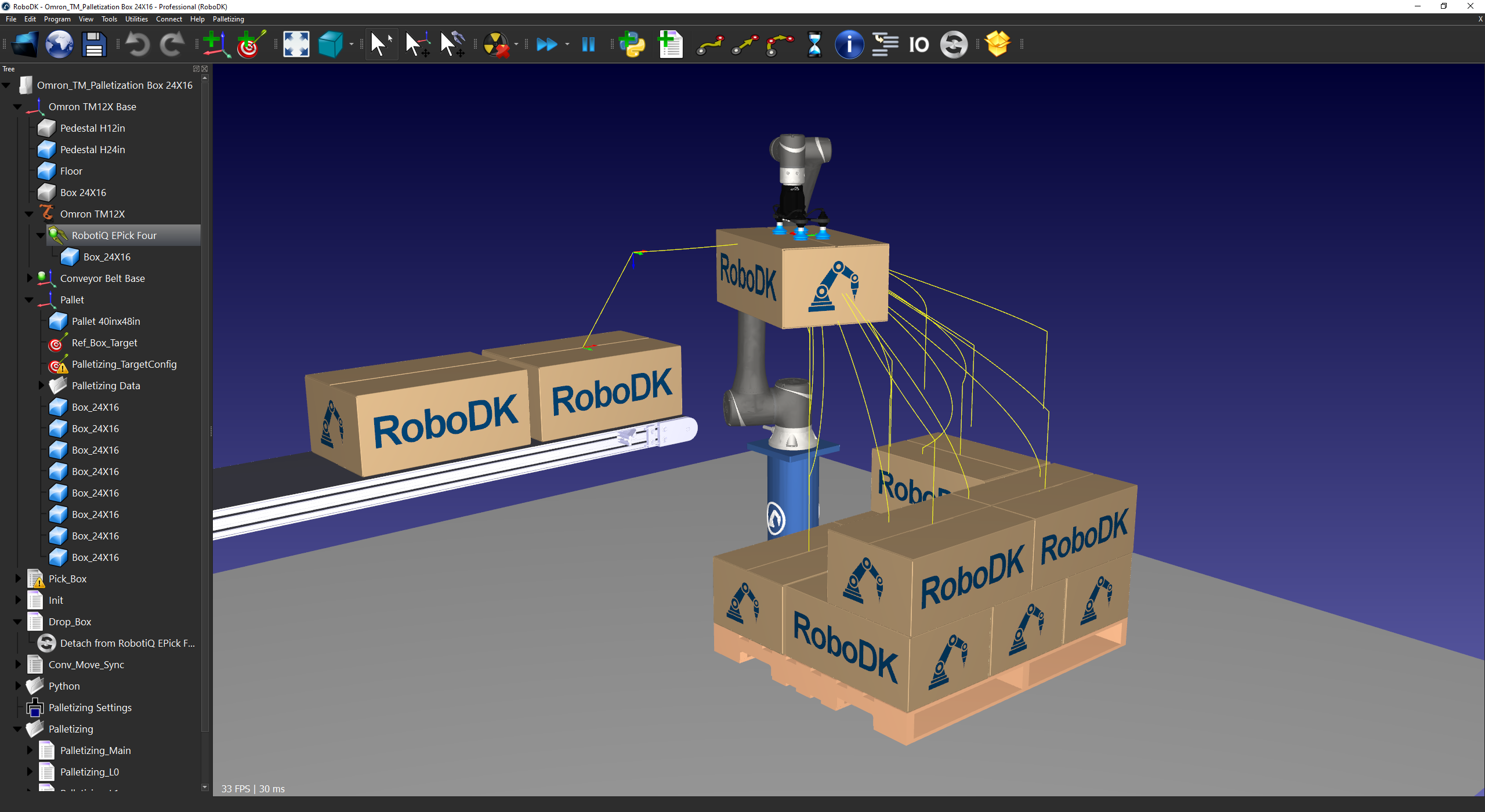

OK Guys, today is the day.  (Updated August, 24)
You can now test a beta version of the Palletizing Plugin.
To give you a bit more context, our goal was to create a flexible palletizing feature that lets you create any type of pallet layout using an intuitive 2D environment.
We this new feature, I was able to reduce the time it takes me to create a palletizing project by about 80-85%. As a RoboDK user first and foremost, I can tell you that I'm very excited about this one. I really hope you guys will share my excitement!
To help you get started I recorded 2 videos, a first one showing you how to install the plugin and a second one showing you how to use it.
More videos will be added to showcase more features and ways you can use the plugin.
Install the Palletizing Plugin:
Video: Palletizing Plugin - Beta - Install
Steps:
1 - Download the .dll of the Palletizing Plugin.
2 - Open C:/RoboDK/bin/plugins, delete any "PluginPalletizing.dll" file you would find there.
3 - Paste the .dll of the Palletizing Plugin you just downloaded.
4 - Open RoboDK.
5 - Go to Tools -> Plugins and activate the Palletizing Plugin.
Basic tutorial Palletizing Plugin:
Video: Palletizing Plugin - Beta - Basic Tutorial
Steps:
1 - Create a palletizing station with a robot, a tool, a box, a pallet, a picking program, and a pallet reference frame.
2 - Open the Palletizing Plugin.
3 - Select Palletize.
4 - Select the right Reference frame and the right Robot configuration.
5 - Import the object (box) and the pallet.
6 - Define your layouts and your layers.
7 - Add Program calls to initiate specific actions during the palletizing process (ei: Init station, pick object, drop object).
8 - Generate the palletizing program.

Hi Jeremy,
the plugin is great,
Is there a way to make the approach keep the z-axis of the robot tool towards the ground (or to fix it), the only way to do it currently was to change every moveJ to moveL. That way it prevent the object from doing a flip in the air
Hi
This problem is related to the approach point configuration.
Did you properly set the configuration reference in the first tab of the plugin? You should pick a target right over the pallet to help the algorithm figure out which conf to use.
If you did so, you can also limit the range of motion of certain joints (double click the joint limits in the robot panel).
I would target J1 so that it can't allow the configurations you see there.
Let me know if it helps.
