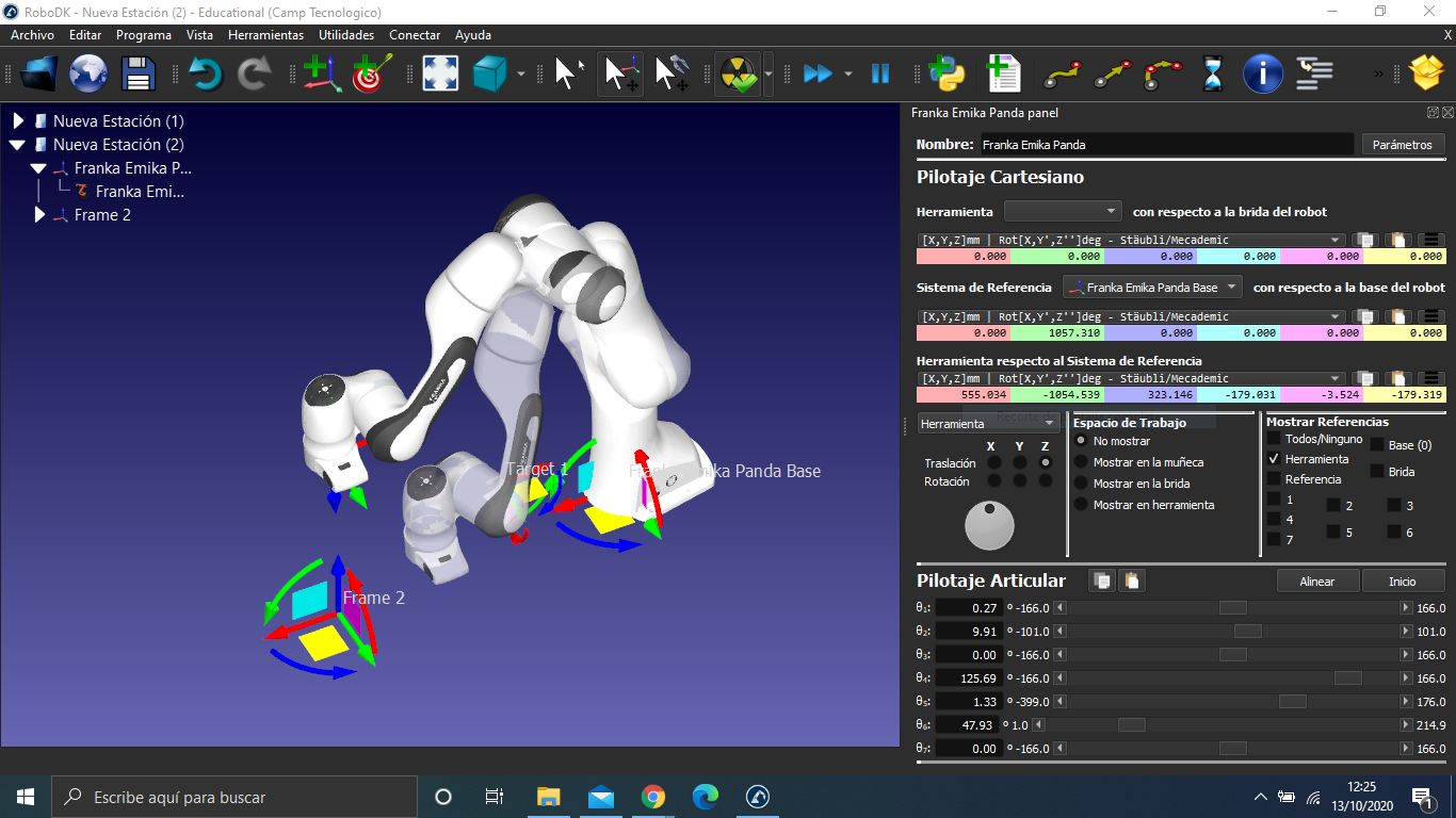

I have managed to introduce the 3d model and create the robot model with the limitations of the axes within roboDk, I have created the robot file, but I have a problem that I cannot solve, since when entering a target it produces an offset with respect to the flange. I leave an image to show the error that I have, can someone tell me how to eliminate that offset?

Hi EndiCamp,
For 7-axis robot you need to activate the iterative kinematic.
"Robot panel"->"Parameters"->"Inverse Kinematic"->"Options"->"Use iterative kinematics".
You need to note that an iterative kinematic won't give you perfect results, if you want to have a perfect kinematic, you can create this robot as a 6-axis robot with J3 locked at 0 deg.
