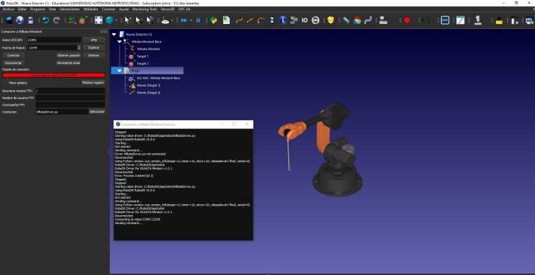

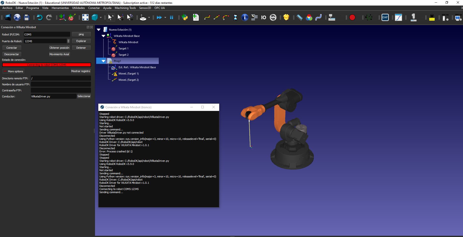

Hello again, I already tried with the new version 5.9.0 but it still won’t connect to the robot. Is there any other way or something else I should try? Thanks.
When trying to connect for the first time, it shows an error, and on the second attempt, it just makes the robot restart and it stays on "Sending command" without progressing.
