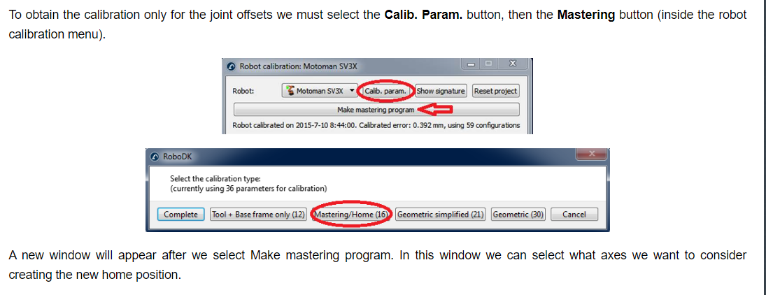

The manual has a page showing a "make mastering program" method using a button that I don't have. I'm wondering if I need to master this arm better first, or what else is going on. Maybe I should update the kinematics in the controller and try again?  I have a couple clone drives so I'm not worried about messing one up.

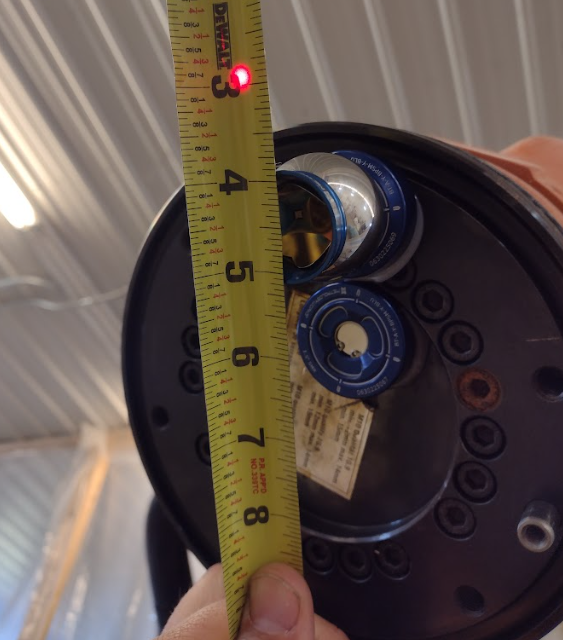

I just checked my SMR by mounting it on the tracker base nest and measuring it, then rotating it in the nest to various angles and the measurements are all within 0.02mm, at any angle or straight on.

Still not sure why the calibration program isn't giving me good numbers, but I'll try mounting the tool again on Monday and put the SMR on it a little further from the A6 axis. Maybe I'll update the RoboDK model with my manual length measurements as well.

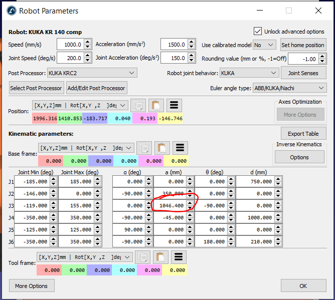

I tried the same method above only moving axes 2 and 3, to find the length between them. That came out to be 1046.4mm (nominal is 1050mm).
I updated that parameter here, is that right?:
But rerunning the claibration, it still expects the SMR to be 1.5 inches away from where it is.

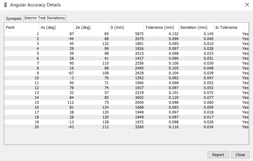

I just tried the compensations in this section https://robodk.com/doc/en/Robot-Calibrat...rackerTest and my tracker passed, so I don't believe it's the tracker at this point.
Results:

It's actually pretty well laid out, I just rush through things when I'm reading. The mastering program procedure confused me (didn't know I had to click parameters, mastering, then OK to make the button appear), and the "follow tracker" checkbox isn't explained, but it essentially validates my cell on the first calibration pose.
