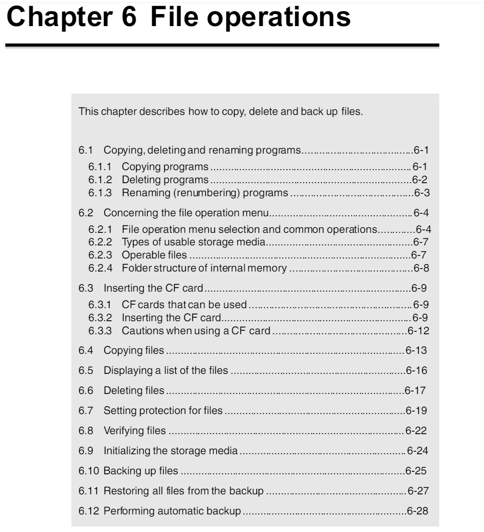

If you have an AX-C controller, please take a look at chapter 6 of the official manual.
I've found it here:  https://www.scribd.com/doc/309799921/otc-manual-pdf
