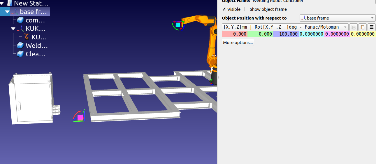

I have added a new station and added a reference frame named as the base frame. When I import an object and set the reference frame to the base frame and set the x,y,z as 0,0,0, even then the object is not loading at the set coordinates. Could anyone please suggest to me a solution to this? I am attaching an image along with this post
Hi Akilesh,
Many reasons could explain this issue.
1 - Where's the origin of the loaded 3D model?
2 - Are your reference frame and robot base really aligned?
3 - Is the part itself at 0,0,0?
4 - Is the part geometry really at 0,0,0? (Object panel -> "More Options")
