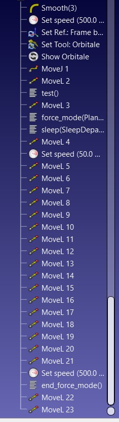

When using curve follow project, the "program events" section works fine for "Path start" and "path finish", but the "on action" doesn't add an instruction at each point. we need to add a line of code at each and every point to keep track of the tool Z orientation at each of those points.
The project is for surface finish of stainless steel and we imported a 3d cad model of the part, extracted a curve then added a CFP for a curve. Every other "program event" works except "on action".
I tried for code and even for a program, but the path instructions show all the MoveL back to back without the actual additional instruction in between.
What am I missing there ? Am I misunderstanding the intent behind the "on action" option ?
