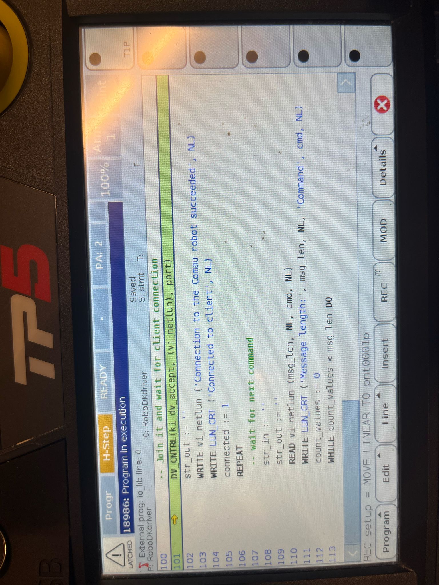

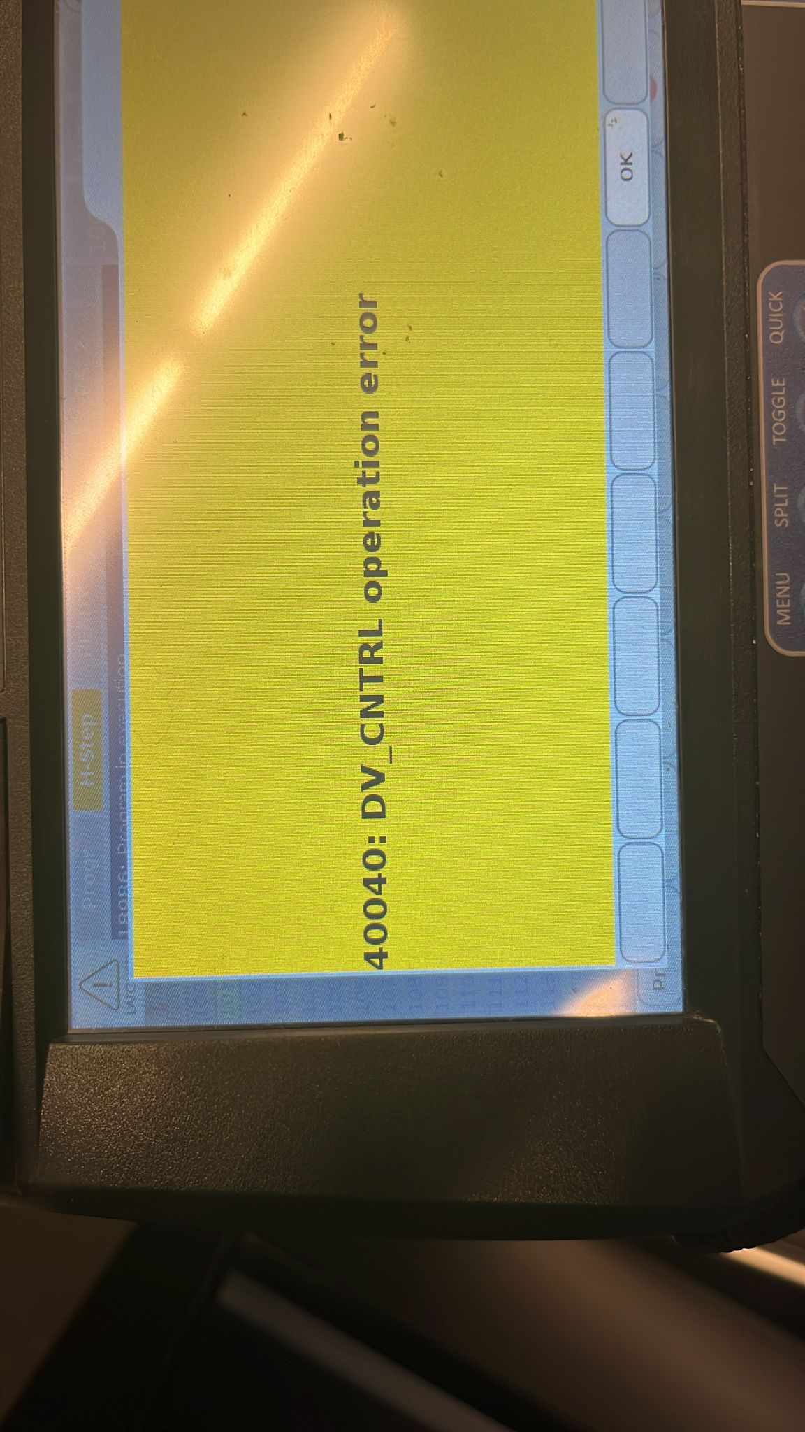

Has anyone had success connecting to a Comau robot and getting the current position? I am able to ping the default IP 192.168.29.2, but the I don't know what port to connect to. Any suggestions?

You may need a special option on the Comau controller to use the DV_CTRL function.

I recommend you to contact your local Comau representative to see how to add this option to your robot controller.

I believe this is something you should pay for, like a product sold by Comau. Or this could simply be something that is supported on more recent controllers.

I am having the same issue for the same controller. Have you managed to solve it?
