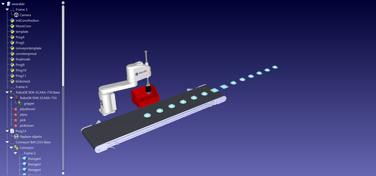

The camera detect parts and rejects parts with only 2 holes in the flange.
All works except the Pick and Place of part.
The robot movers but the part does not attach.

The camera detect parts and rejects parts with only 2 holes in the flange. All works except the Pick and Place of part. The robot movers but the part does not attach.
03-27-2024, 08:47 AM
This is solved. I will post the finished demo. I just used the simulation tool to attach and detach and called it from the python program.
