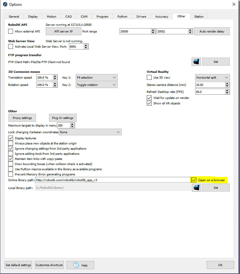

* It used to work normal, in which library is shown in the left half of RoboDK window.
* Now, it opens up the web site without showing them on RoboDK.
* I reinstalled RoboDK, but the problems remains.
How can I fix this problem ?
You can change the settings here to get the desired Library window on left.
Thank you so much.
I was so surprised that the setting suddenly changed after the RoboDK clash and can never be restored even after reinstallation. (I'm using Windows 10).
