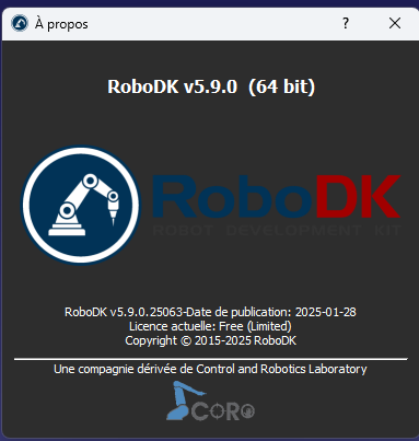

Can you provide a print screen of the Help-About menu? It should say the build date is today (February 19th), with a newer build number. This is a new version even if the name of the installer is the same.
I agree that having the same installer name can be misleading. We'll prevent this confusion in the future.
I just tried a fresh download (and I'm sure I did not use the old installer downloaded a few days ago) and a fresh install in another drive of my computer and get a build date of 2025-01-28. I still have my v5.4 installed in another drive if it's relevant.
OK the problem should be fixed now. You should now see the correct build number of RoboDK on the installer:
Install-RoboDK-64-v5.9.0.25130.exe.
There was a cache issue with the download that should be fixed now.
Everything is working now,
thanks!
