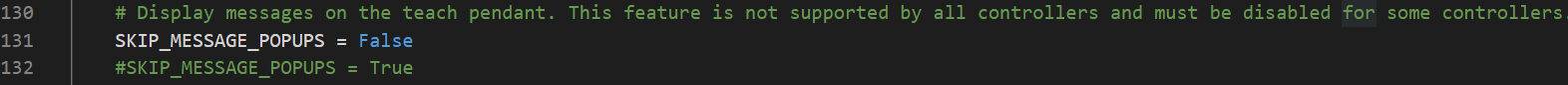

Hi okin,
I think that simply setting this flag at True should do the trick.
You can also remove the content of this function.
