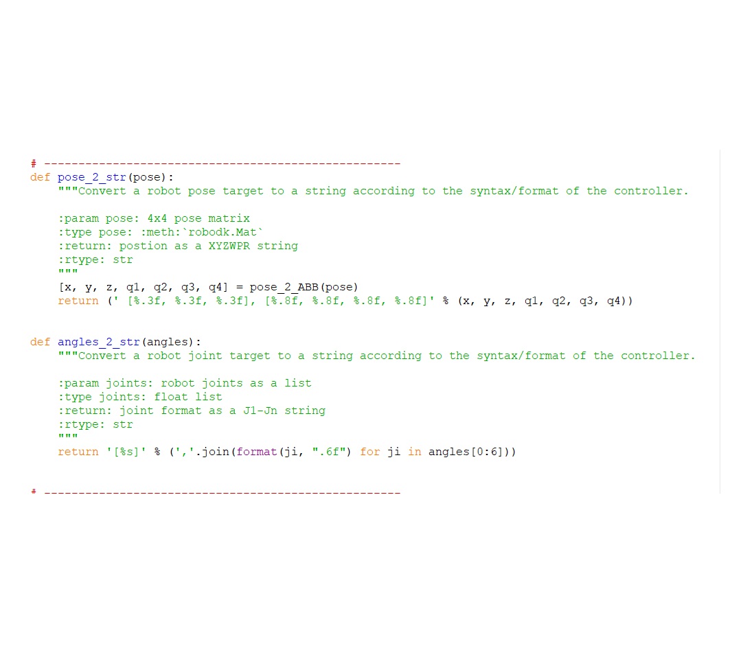

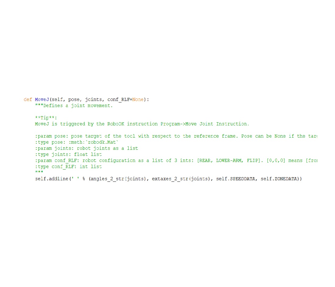

Here are the three section modifications which I have done on the Post processor file which was sent to you. These modifications (on two attached Jpg files) were done based on the hint and the link which you send them for me. In addition, you could find the Error message which I have received after applying the Generate Robot Program command.
Thanks, and look forward for your expertise advice
Post Processor Modification 2.jpg    Post Processor Modification 1.jpg    Error.jpg

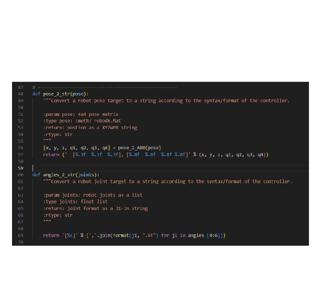

There is a variable mismatch between joints and angles in the function angles_2_str. You should replace the name angles by joints.

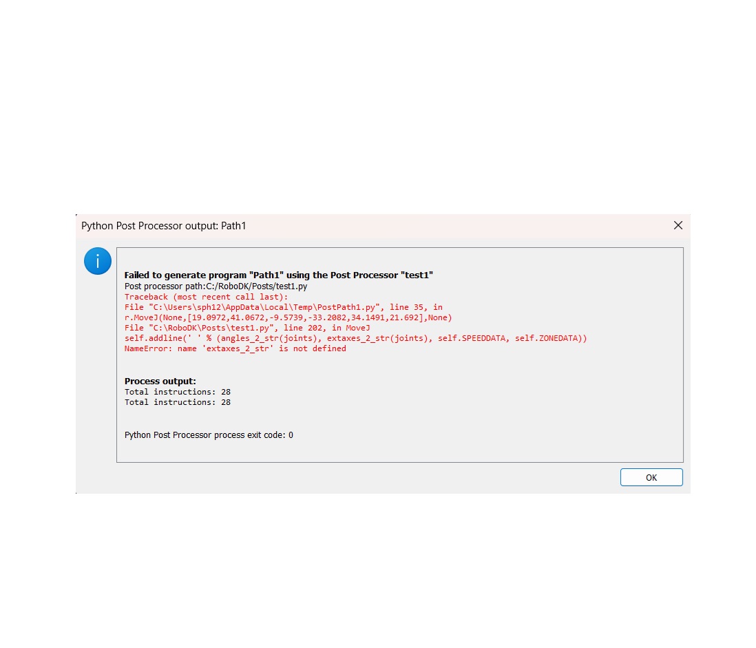

Here is the modification based on your advice and the received new Error.
Regards
.py   test1.py (Size: 21.12 KB / Downloads: 632)

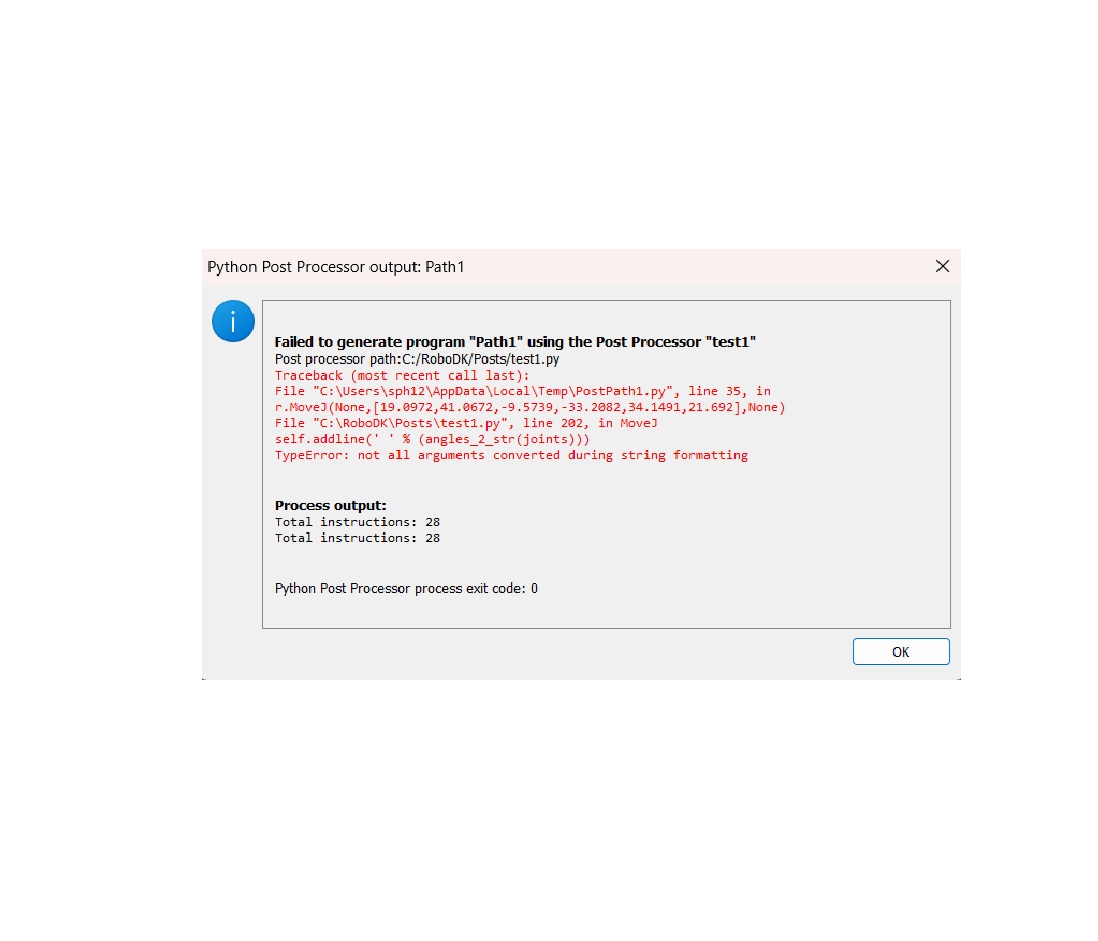

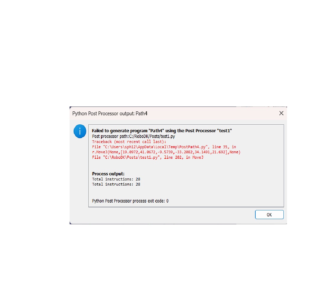

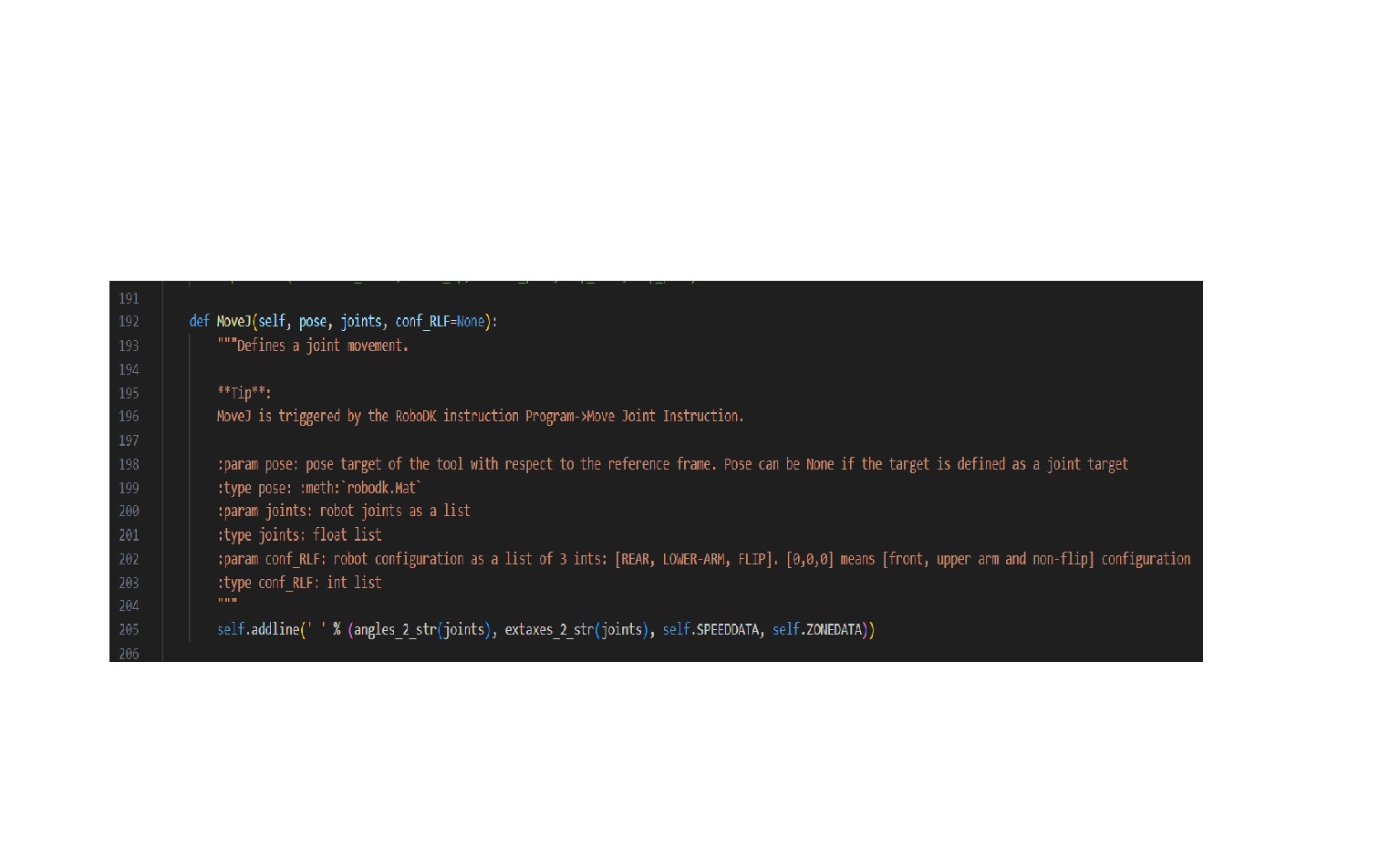

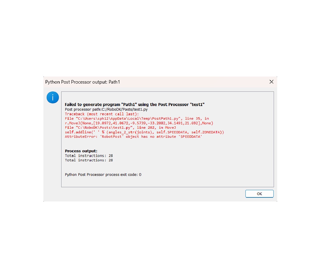

You should remove the extaxes_2_str function call if you don't have external axes.

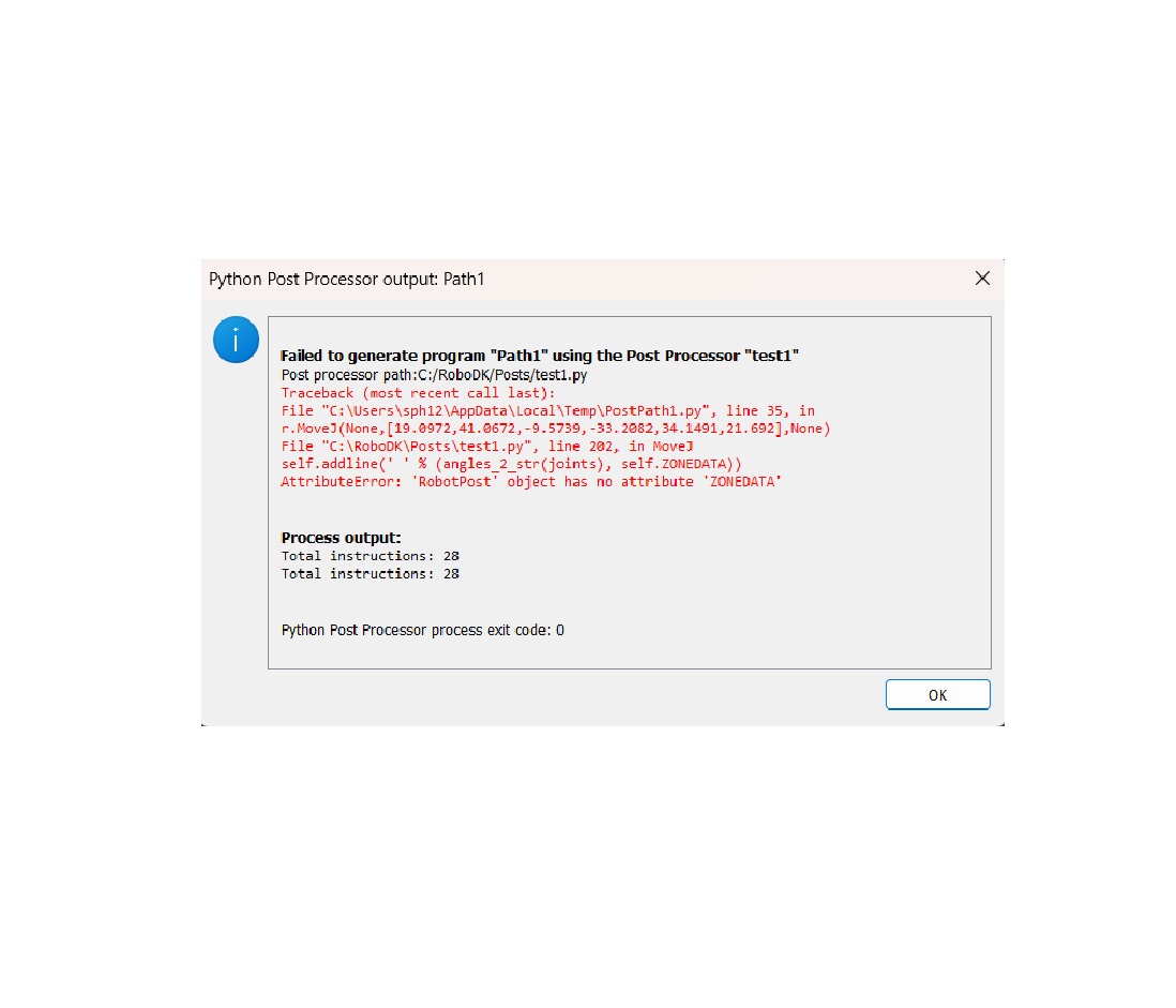

Based on your Recent suggestion the “extaxes_2_str(joints)” was removed and Error 1 is generated after. As I understood your trend of correction I estimated your next step will be to remove the “self.SPEEDDATA” then the Error 2 was generated. Moreover on the step after I removed the “self.ZONEDATA” and I received the Error 3.
