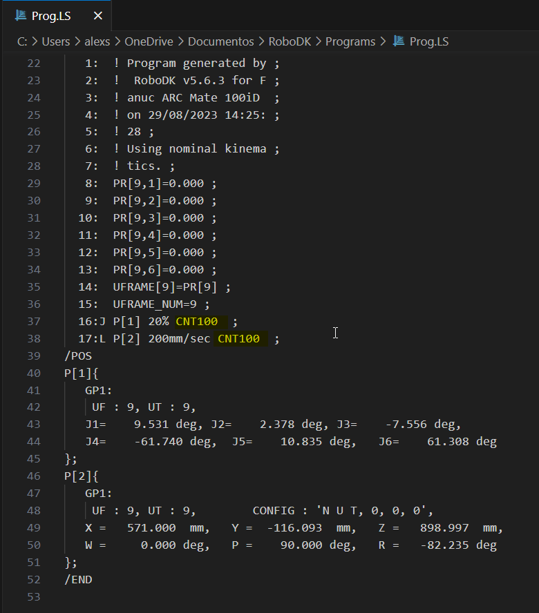

I have adjusted the post processor for CNT100 and it still gives me FINE. I am certain this is what is the source of our poor robot motion. What can I do to make all the motions CNT?
Thank you.

Okay, I think I got it figured out. Little back door solution ;)

Thank you for letting us know. Just to make sure you change it properly, when you trigger a program call (such as the Extruder function), the post processor will force the last movement to have a FINE rounding. You can configure this behavior in the RunCode function of your post processor.
