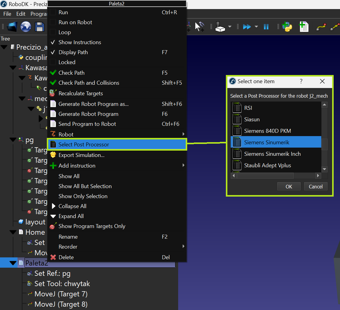

I am using a Comau robot which is controlled by a Sinumerik 828D system. Can you help me how to set up the postprocessor or which postprocessor to use for the proper functioning of the program?
Yes, it is possible. You can r.click on your program, then 'Select Post Processor'.
The 'Siemens Sinumerik' post processor should be suitable:
