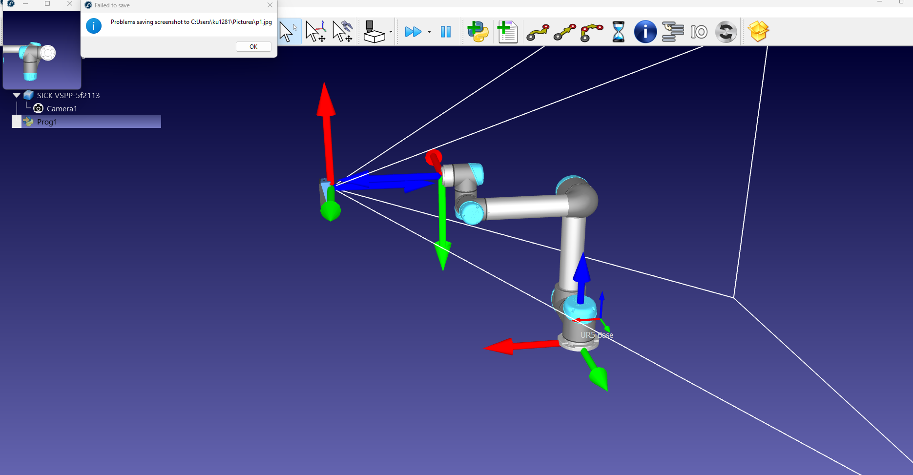

Dear Team,I am trying to use a basic 2D camera and saving snapshot image using a python script, but getting the following error;
"Problem  saving screenshots ......".
 Camera i have used is SICK VSPP-5f2113
I have tried on Windows11 and Windows10 OS, but gives same error
Request your kind support, I am enclosing robodk file and screenshot of error too.

The file path looks incorrect. I recommend you to use forward slashes and properly enter the path of the image.
Example:
snapshot_file='C:/Users/user name/Pictures/p1.jpg'
(12-13-2023, 10:44 AM)Albert Wrote: The file path looks incorrect. I recommend you to use forward slashes and properly enter the path of the image.
Example:
Thanks Albert. It worked. Appreciate your support.
