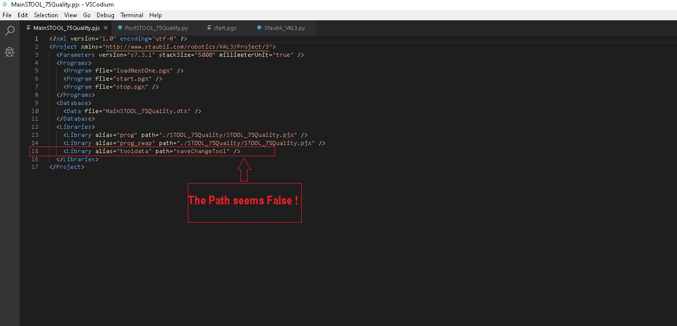

When I send the generated program to the robot,  I become always the error "Invalid Library".
Please see the Photo!
BR
The Fehler message is:
"Fehler in line 15. The library is not available."
when I checked the generated program, I didn't found that library (tool date), and also there is no path called (saveChangeTool).
Any ideas !!
You'll find the dependency here:
https://robodk.com/forum/Thread-Staubli-...26#pid1026
You may need other dependencies if you use your Stäubli robot for robot machining. I recommend you to contact Stäubli for these tools.
