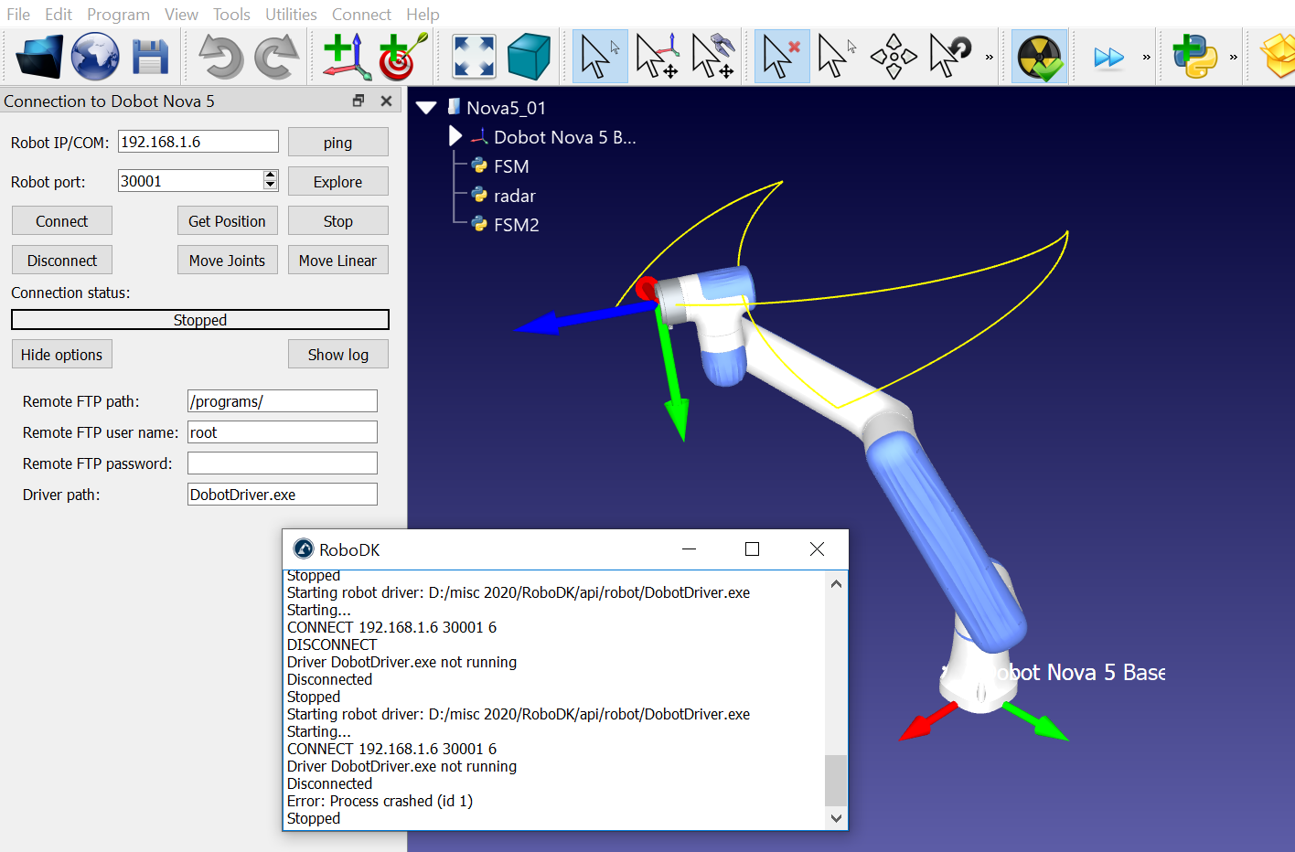

I'm trying to connect a Nova5 robot to RoboDK, via WIFI.
The driver is installed but crashes.
Log included here as attachment.
Please help. Many thanks!

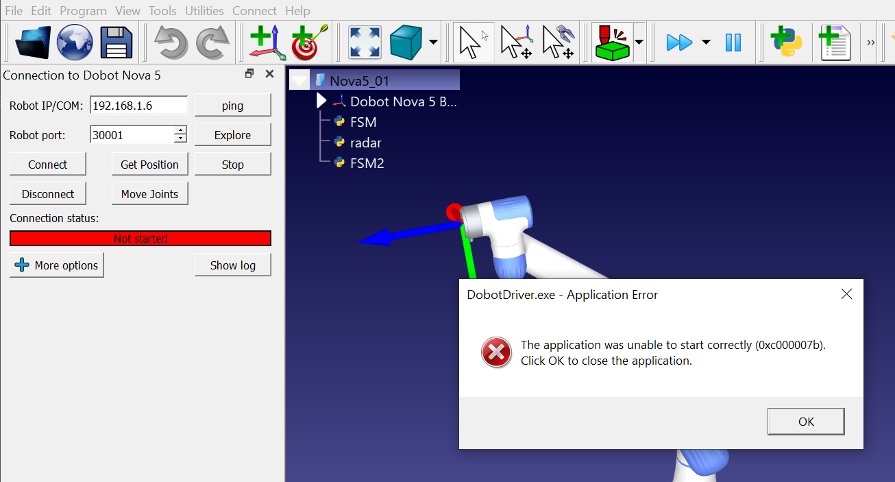

I installed the latest version of RoboDK, now getting the following error:
Can you provide us with the full log?
What operating system are you using?
Did you try with the 64 bit version of RoboDK or 32?
Please use the 64 bit version as it has more features, including the latest version of the Dobot driver.

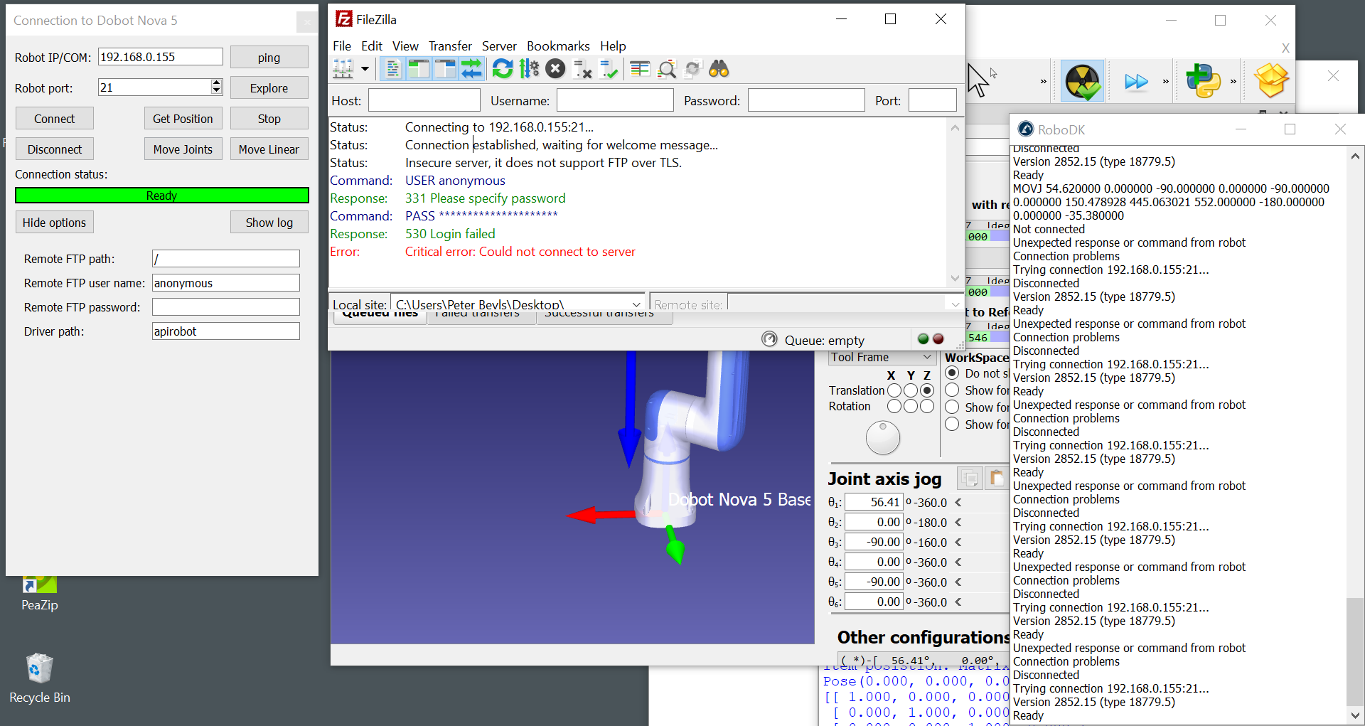

I'm using Windows 10 with 64bit version of RoboDK.
When hitting the 'çonnect' button it takes about 30 seconds to get 'ready' message. Then error message follows. A log is included here:
Hello RoboDK Team,
Could you please help with the following problem.
I am now using a new setup but having a problem connecting to the Dobot Nova 5 robot.
Setup is as follows:
computer: HP Pavilion All0in-one desktop
64-bit operating system, x64-based processor
operating system: Windows 11 Home
Robot IP/COM: 192.168.0.155
Robot port: 2000
Driver: DobotDRiver.exe
When hitting the "Connect" button; the Ready button first displays "DeviceSN u", then "117.1.0" and finally "Ready" - after about 30 seconds.
A log is included:
Driver for RoboDK 5.9.3.25343
Disconnected
Stopped
Starting robot driver: C:/RoboDK/api/robot/DobotDriver.exe
Using RoboDK RoboDK v5.9.3
Starting...
Dobot Driver v3.0.2
Sending command...
Loading settings: C:/Users/peter/AppData/Roaming/RoboDK-Drivers/DobotDriver.exe.ini
Using Dobot M1 robot (scara): No
Not connected
Sending command...
DeviceSN u
Device Name u
117.1.0
Connection Succesfull
Ready
Sending command...
Working...
Ready
When hitting the "Get Position" button, the log displays: Sending command..., Working, and Ready.

This python program provides a listing of items but not the position.
Could you please help.
Thank you!
