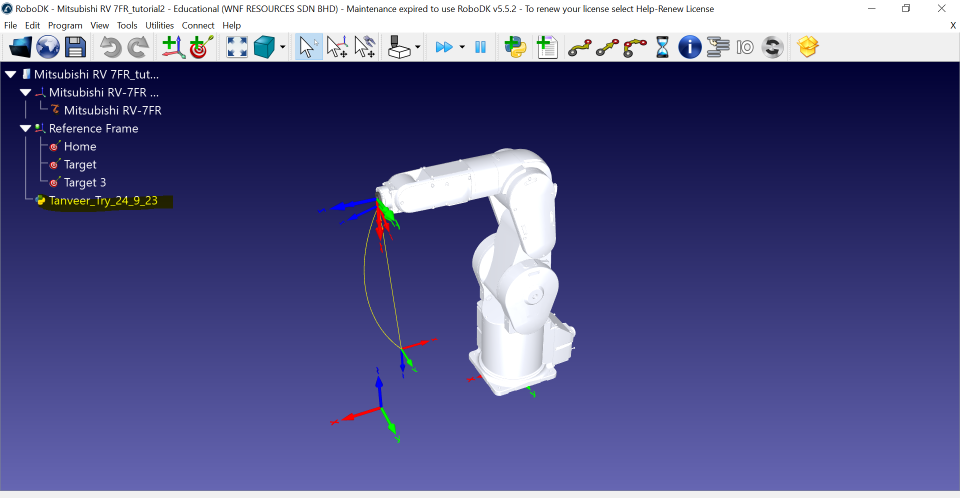

Hello, I am trying to convert a Python script to the robot prog for the Mitsubishi robot. When I select the "generate robot program" the whole RoboDK software collapses and shuts down. Kindly clarify what could be the problem. I am using roboDk v 5.5.2. And here is my code.

Also, kindly take note that the Python script can simulate the motion properly. I am also attaching the project file herewith for your reference.
.rdk   Mitsubishi RV 7FR_tutorial2.rdk (Size: 1,008.08 KB / Downloads: 570)
Thank you for letting us know about this bug. We were able to reproduce it and it will be fixed with the new release in the next week or so. If you prefer downloading RoboDK version 5.6.3 you should not have this crash.
I just checked with version 5.6.3....the crash still happens
The crash can happen with a custom Mitsubishi post processor and previous versions of RoboDK. Thank you for letting us know though.
We'll make sure to fix the crash with our next release this week.
