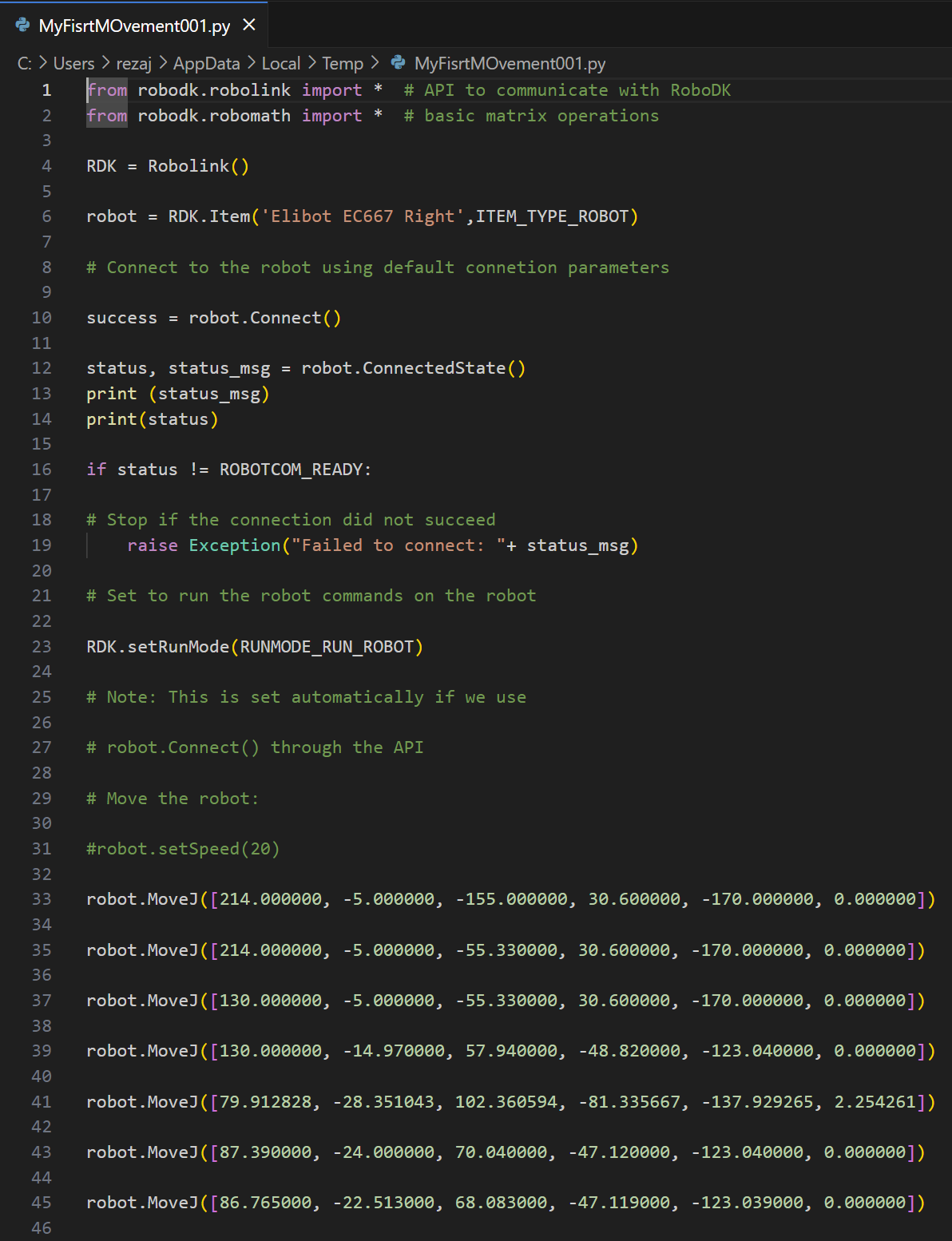

I have written the following program in . But sometimes the program runs completely and the robot does the work perfectly. But in most cases, especially when I make a small change in the program. Only the first command runs and the other commands do not run. This means that the position of the robot joint only changes upon the first command. Do I need to make any changes or is there a way to monitor the program?

Thank you, Albert, for your reply.
I noticed a new issue. Apparently, RoboDK is working, But it is busy adjusting the joint value and has not yet reached the desired number. in this video the robot (and teahpendant data) reached the position immediately, but for RoboDK itself it takes time to move to the position. And when it reaches that number, the next command is executed. All this time the text "ready" to be displayed as log (if I understand you correctly). link of video: https://drive.google.com/file/d/1BAuyguh...sp=sharing link of images: https://drive.google.com/file/d/1bgK0laM...sp=sharing https://drive.google.com/file/d/18W3Z-gk...sp=sharing

(12-24-2024, 06:00 PM)Albert Wrote: It looks like you are using an old version of RoboDK or the driver. Unfortunately, after updating RoboDK and connecting with EliteRobotDriverEC.py, the robot without any error became unresponsive. Previously, using the ElibotDriver.py provided by Elitrobot, I was able to move the robot with the same code. I've exhausted my troubleshooting options and would greatly appreciate your guidance.
