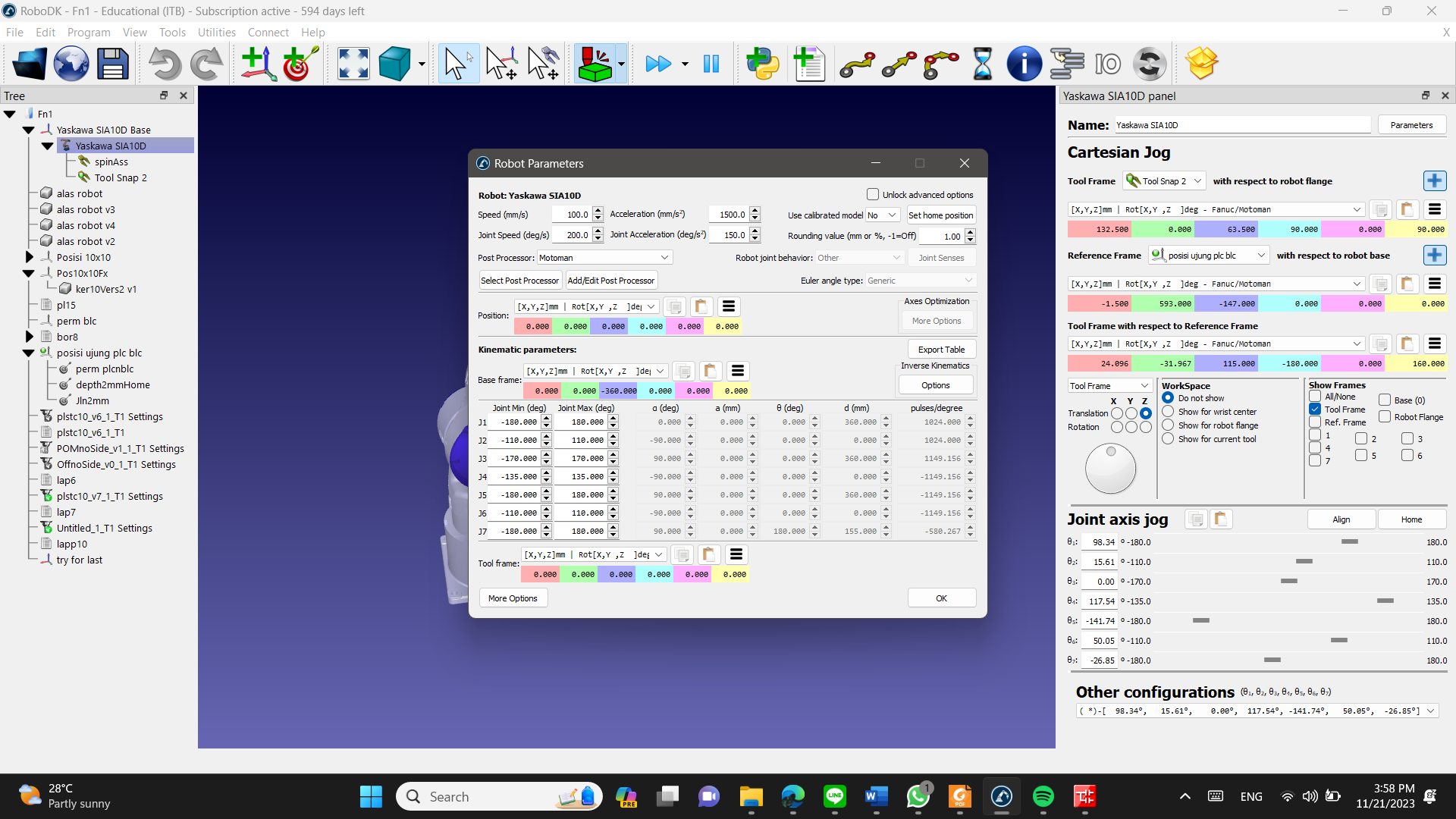

the program lapp102 give me the issues.
about the pulses/degree ratio and joint limit, i dont change any setting about that and let it on default setting.
In this case I would review the joint limits, or try to split the program that is giving you issues into smaller programs to better narrow the line that is giving you issues.
