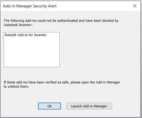

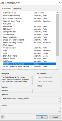

Hi Jeremy!
I tried to do that, but it seems like there is still a problem.. Finally it showed up in Inventor Add-ins, but it is blocked.. Do you know what went wrong? (See my attachment)
Thank you!
Best regards Kari
There is a "Block" checkbox in the Add-In Manager.
Just uncheck it.
Hi!
I needed to also check the "Loaded/Unloaded" and "Load Automatically" to make it work. Thank you!
