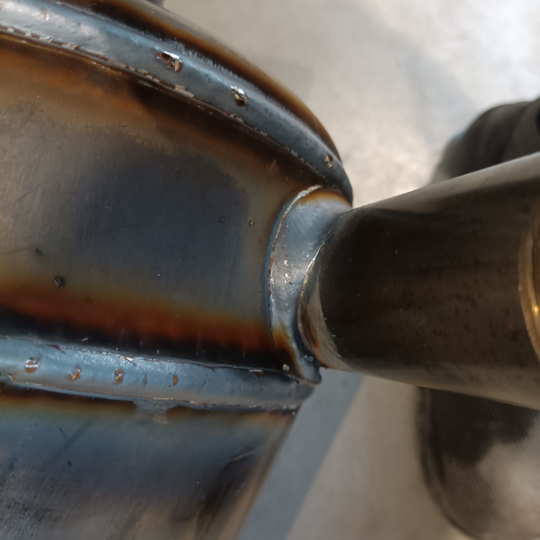

These changes in speed lead to sudden changes in the thickness of the weld. (image)
