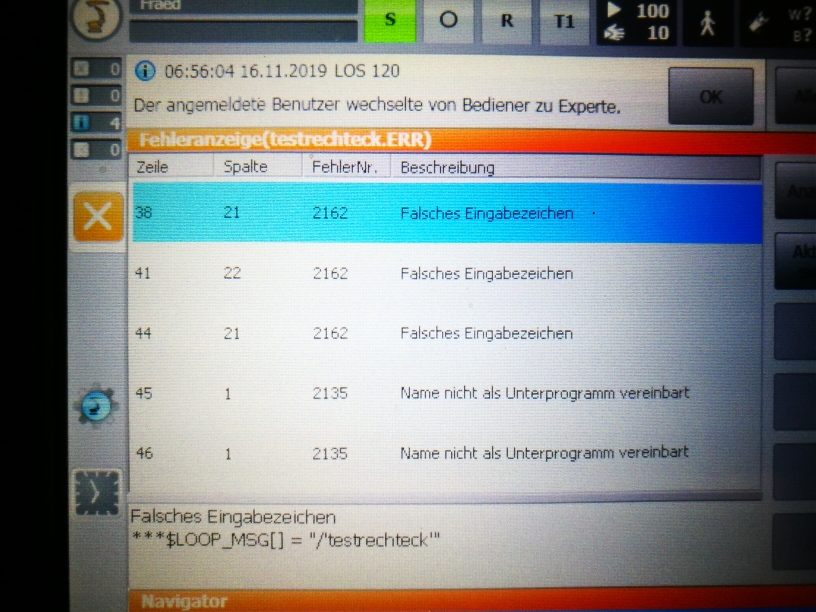

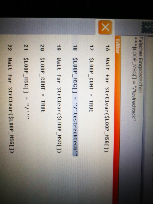

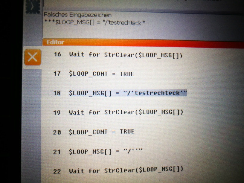

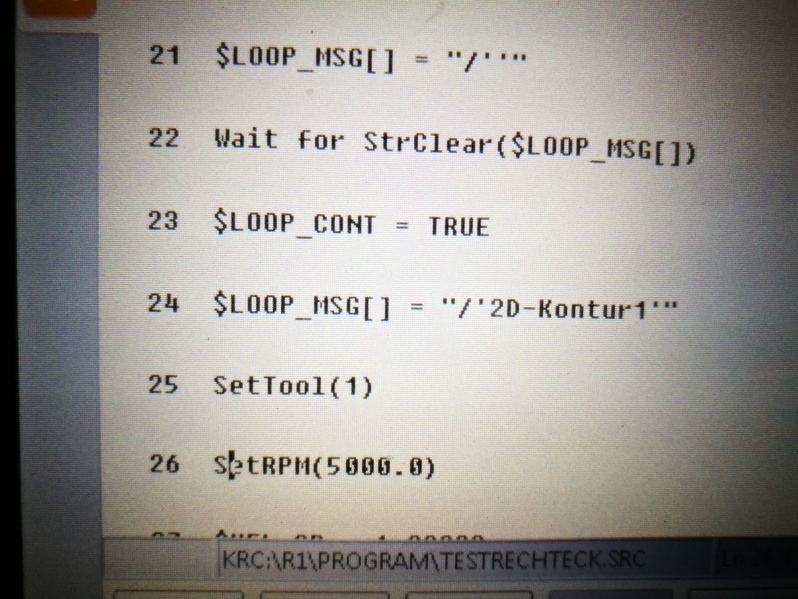

thank you for your fast help. i think there is a problem with the "loop" and the "setrpm" command.
in attachment you can fnd the error list.
I recommend you to try the KUKA KRC2 post processor.
Also, RoboDK automatically creates program calls for you to integrate with machining spindles (I assume you are using the robot for robot machining). If you want to remove or customize these calls (SetRPM, SetTool, etc.) you can modify it in the Program Events section.
You can also skip generating program calls using this setting:
  • Tools-Options-Program-Skip program calls that don't exist in the station
