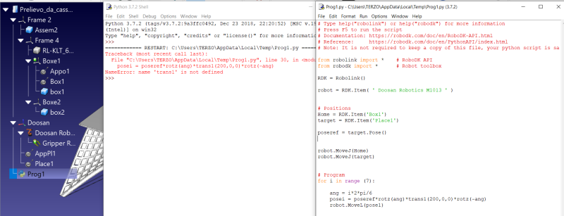

Hello comunity,
I tried to copy the program showe on this video
https://www.youtube.com/watch?v=Ic-iKGSc7dk
But I have error when i run the program:
trans1 -> variable is not defined.
the code is the same of the link.
How can i resolve this issue?
Thank you.
Regards
[url=https://www.youtube.com/watch?v=Ic-iKGSc7dk][/url]
Hi Andros,
This is an API question, please post the proper forum section next time.
Looking at the print screen, it looks like you wrote: "trans1" (trans and the number one) instead of "transl" (trans followed by the letter L).
