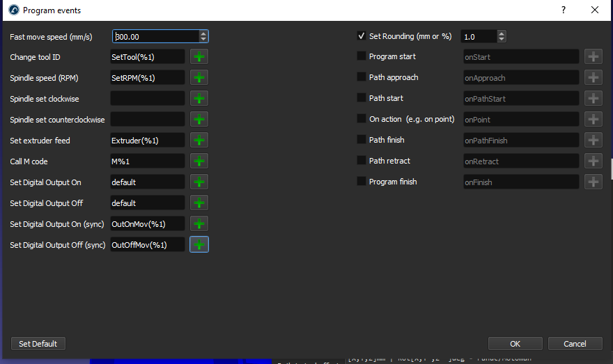

Well, the way I solved this was to post out everything NOT in gcode, as M code from whatever program I use.
In the Program Event window I change to M%1 as you can see. I use subprograms named; lets say M104. Inside M104(not the mcode but program) I would write T1 S260.
This is my solution of "not bothering to properly setup my robots", but as we change our setups quite alot ( as in prototyping) I do not bother fixing everything more than I have to and it works very well as robots do not care if I call my programs for M***
