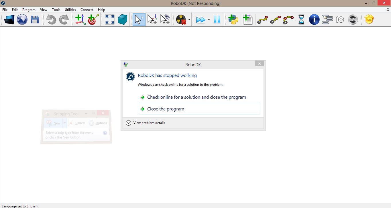

Problems running RoboDK on Windows 8
The software setup is downloaded from the website and is installed on the computer.
After that whenever I try to start the software, it starts and immediately I get an error that RobotDK has stopped working(image attached).
and this error appears twice in a row.
on clicking on 'more details' option I get the following message.

I would really appreciate your help in solving this issue.

Thank you so much for your reply. The software is not starting with 'C:/RoboDK/RoboDK-Safe-Start.bat' file. Also while starting the 'C:/RoboDK/RoboDK-Debug.bat' I am getting the same error. It shuts down with a RoboDK has stopped working message. I am attaching the RoboDK.debug.txt file with this message.

While starting with C:/RoboDK/RoboDK-Safe-Start.bat, the software started and immediately I got the 'Robodk has stopped working' error. The same one I get while starting the software normally.
