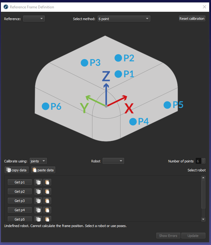

1. Is there a method available in the Python (or any other) API to access the Reference Frame Definition feature (below)?
Ideally, I would input:
- The robot base reference frame
- The robot
- `list[list[float]]` representing the joint positions at each of the 6 points used to generate the reference frame.
2. If so, is it possible to overload this method with extra measured points to get a more accurate fit?
I searched the API documentation and was not able to find any relevant hits for "frame definition" or "define frame".
I do know that this is not that hard to do with robolink plus robomath, numpy, or open3D, but I would like to take advantage of the existing feature since it's already been well-tested.
