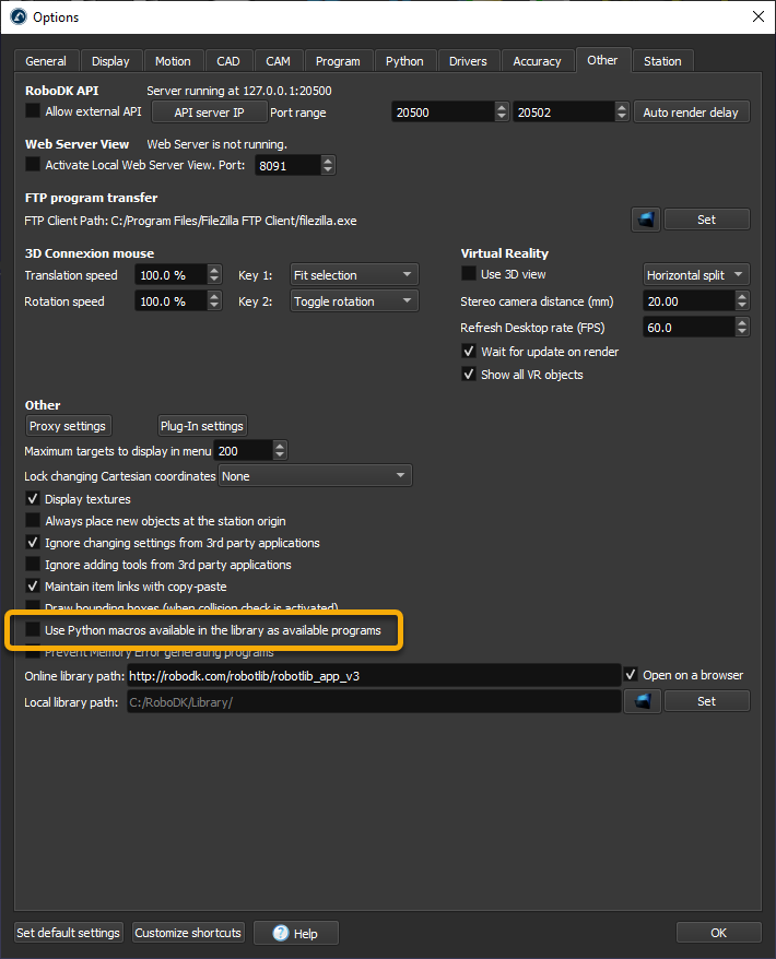

If you need to call them from the UI, you have 2 choices.
You can simply delete the macro you have in RDK every time you do a modification and redrop de new version in.
You can also save your python macro in RDK's local library and activate this option. You can then call the macros even if they are not part of the station.

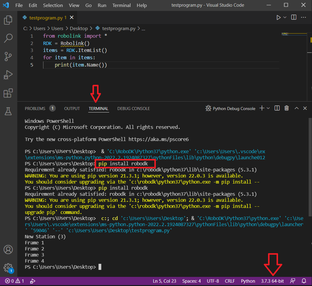

More specifically, if you are using VSCode, you should follow these steps:
  1. Install the official Visual Studio Code and open it from the start menu.
  2. Choose the Python version you want to use from the bottom Right (you may find it on the bottom left depending on the VSCode/VSCodium version).
  3. Place your cursor in the terminal (select View-Terminal if you don't see it)
  4. Type "pip install robodk". This should install RoboDK for the chosen version of Python and it should work outside your RoboDK environment.
  5. Select F5 (or Run-Run) and enter to run your Python script.
See attached image.
At RoboDK we do most of our research and development in this manner because it is easy to keep track of the source code.
