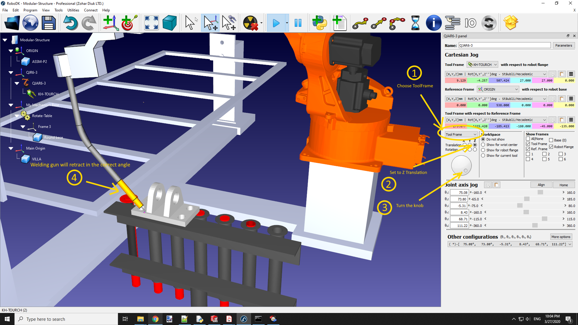

In RoboDK GUI it is possible to choose "Tool Frame" and then using the virtual knob one can change the position and rotate accordingly.
I need this functionality to retract/approach the welding torch from the start welding point

Could you add a print screen showing what you do with the GUI? It would help us help you.
In the figure you can see the steps of making the welding gun retract from the weld position:
1/ choose the ToolFrame
2/ Set to axis Z
3/ Turn the knob
4/ Result is that the welding gun will retract in the tool -Z direction
I want to do the same thing but with Python API.
I know I can calculate the tools position and get the angles compare to the reference frame, but for sure you have some build-in command to do this.
I hope this clears my question.
