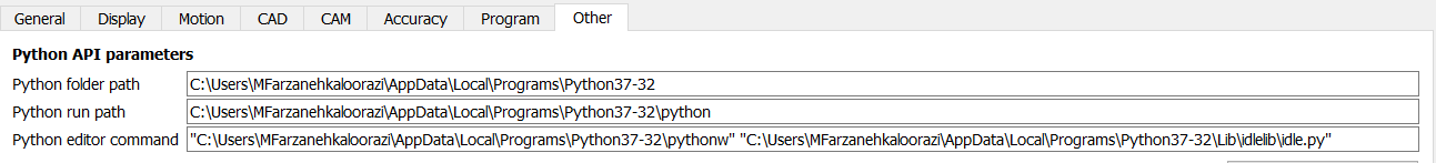

I am using the latest release and this is my RoboDK python path:

Can you provide the RDK file?
Did you install RoboDK from the default installer? You should not move the folder once installed.
It looks like RoboDK can't be found. Also, make sure you are not running 2 instances of RoboDK.
Updated to the latest release and it works fine.
Thanks
