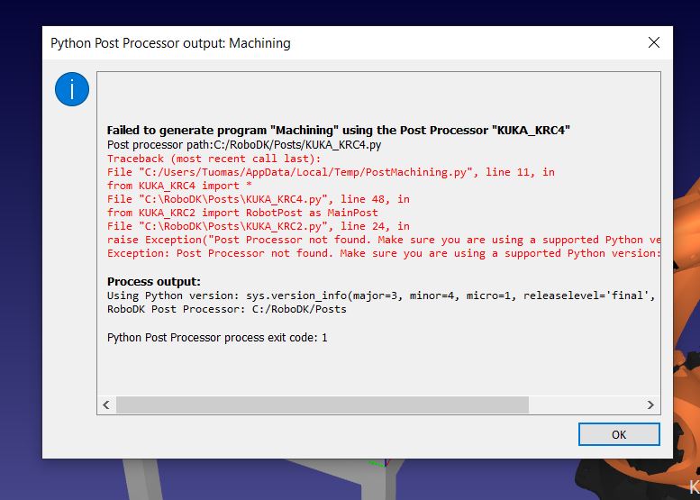

I tried to generate a basic machining program and it gave me this error shown in attachments. Do you know how can I solve this?

Are you able to generate other programs? Which python version and interpreter are you using?

I can`t generate any programs at the moment. Python interpreter shows path C:/Python34/python.exe, I guess the version is 34 then?

Try installing a more recent version and don't forget to change the path in Tool -> Options -> Python to your newest version.
Let me know if that fixed the problem.

I installed new version of RoboDK and changed the path. That fixed the problem, thanks.
