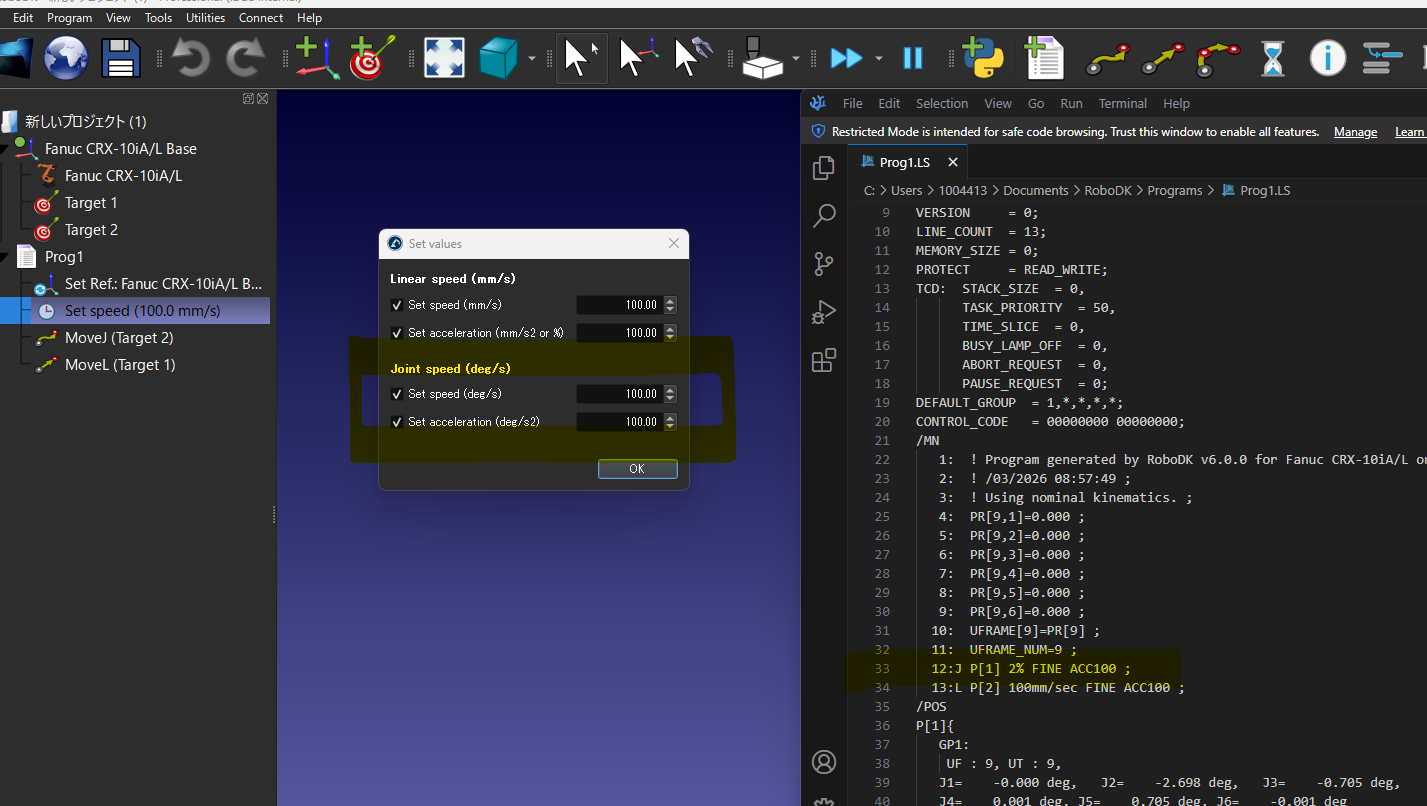

I tested the FANUC CRX speed conversion using the FANUC post processor, and I found an unexpected result:
When I set 100 deg/s for a MoveJ motion in RoboDK,
the generated LS/TP program shows 2%.
Because of this, it seems that the current conversion logic used by the post processor is not correct or does not match the real CRX controller behavior.
Could you please review the conversion again or provide the correct formula that the post processor uses to calculate Speed %?

Good point. I recommend you to split the instruction to set the linear speed and joint speed in 2 (one for each) and set the joint speed after the linear speed. This is the logic for linear speeds which affects the joint speed:
    def setSpeed(self, speed_mms):
        """Changes the robot speed (in mm/s)"""
        # Set the normal speed
        self.SPEED = '%.0fmm/sec' % max(speed_mms, 0.01)
        # assume 5000 mm/s as 100%
        self.JOINT_SPEED = '%.0f%%' % max(min(100.0 * speed_mms / 5000.0, 100.0), 1)  # Saturate percentage speed between 1 and 100
This should output your desired result:
  12:J P[1] 50% FINE ;
  13:L P[2] 100mm/sec FINE ;
See the attached example. The issue is that setting the linear speed also forces the joint speed to be set.
We'll improve RoboDK to make sure the joint speed prevails over the linear speed for Joint movements.
