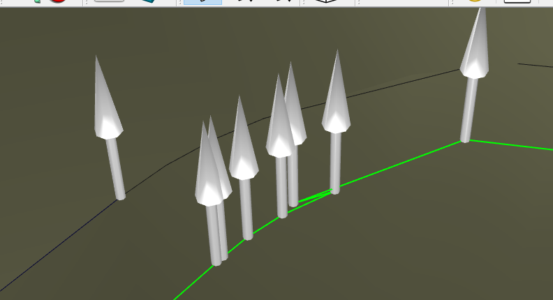

Questions about Curve Follow Project.
Can't we combine them into one when the curves overlap as shown in the picture below?
Did you use the "edit path setting"->"Offset" to have this result?
If so you need to delete a few points from the selected path.
Go to "Tools"->"Modify Curve" -> "Right-click" a point -> "Delete Curve Point"

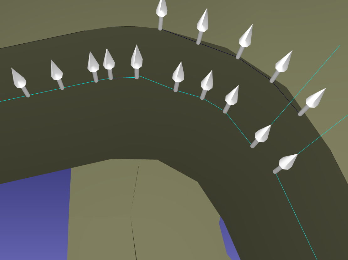

If you use "delete curve point", the line changes weirdly. I want a smooth path.
Yeah, this is not a bulletproof feature.
Do you use a CAD software? If so, which one?
I'm using inventor
Great, did you see we have a plugin for Inventor?
https://robodk.com/doc/en/Plugin-Invento...inInventor
CAD softwares such as Inventor are WAY better at doing CAD work like offsetting lines and stuff.
If I was you, I would create the offset path directly in Inventor and bring it to RDK. Take a look at the tutorials in the previous link or this one from our SolidWorks plugin (works the same as the Inventor one and showcase the line offset)
