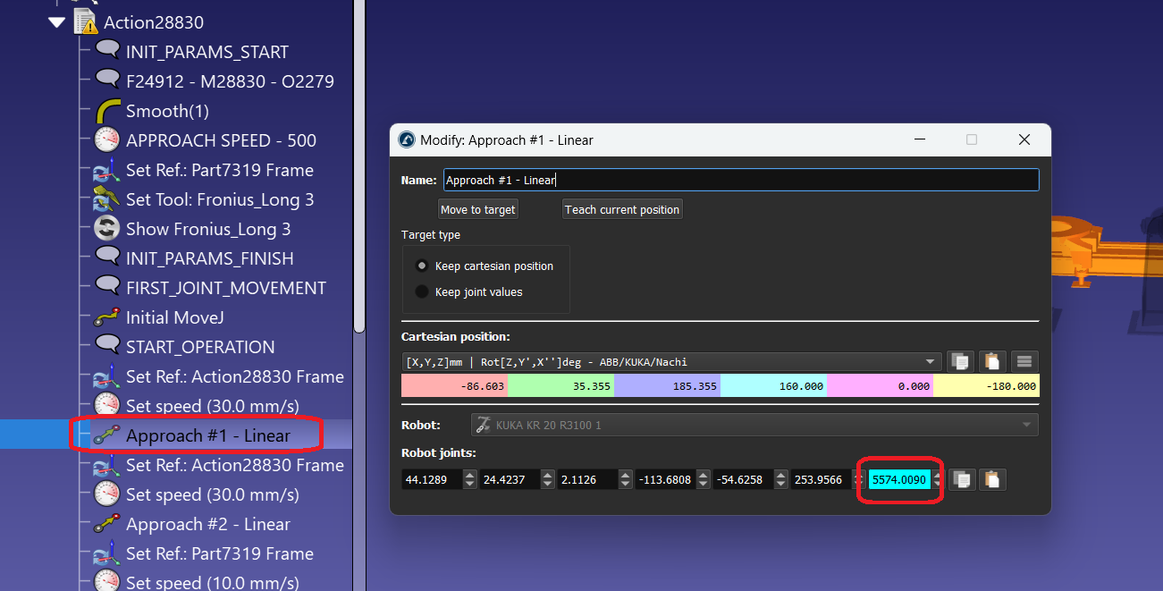

Since you are moving to Cartesian targets you should set the joint value of the rail to the desired value (7000 mm instead of 5574 mm). This is very simple, you can just manually update these values (the blue box of the target data in the joints section represents the external axis).
See the attached image and sample project.

Thanks Albert, that worked perfectly.
