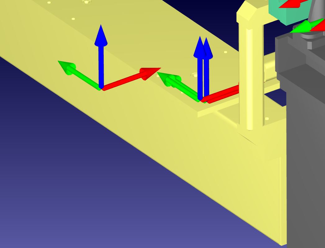

How do you move an interection of an object to the new coordinate system?
Can you give more details? Did you mean how to move the origin of the object ?
(12-29-2021, 06:32 PM)Olivier Wrote: Can you give more details? Did you mean how to move the origin of the object ?
Yes sir.
I have recorded a 3-Point origin from the KUKA Robot. I created and defined a reference frame and now I want to "Move Geometry" to the origin point in the object.
You can apply a geometry move if you click on "More options" after double clicking on the object if that is what you are looking for.
I know how to use the "More Options", but I want to be able locate exactly for a corner, center of a bolt hole, etc.  The way I have been moving the specific location of the part, is to create a "tool measure" point and use "options" of the part, to see the absolute coordinates relative to each other.  I then subtract the absolutes of the X,Y,Z coordinates and move the geometry incrementally by typing in. Very time consuming if I want to move many part coordinate origins.
Anything easier? I have not found anything. Can you do this by frame, teach targets or frames, etc. and copying coordinates to get incremental moves?

Thank you,
That will do the trick.
