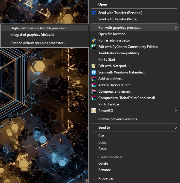

Try running RoboDK with Graphics card, i have 8 gb of ram, an i3-3110m and an nvidia gt710m and i have no problem with simulations.
On laptop if you have installed the graphics drivers and have an nvidia card you can right click the shortcut and click on run with graphics processor ( see image ).
