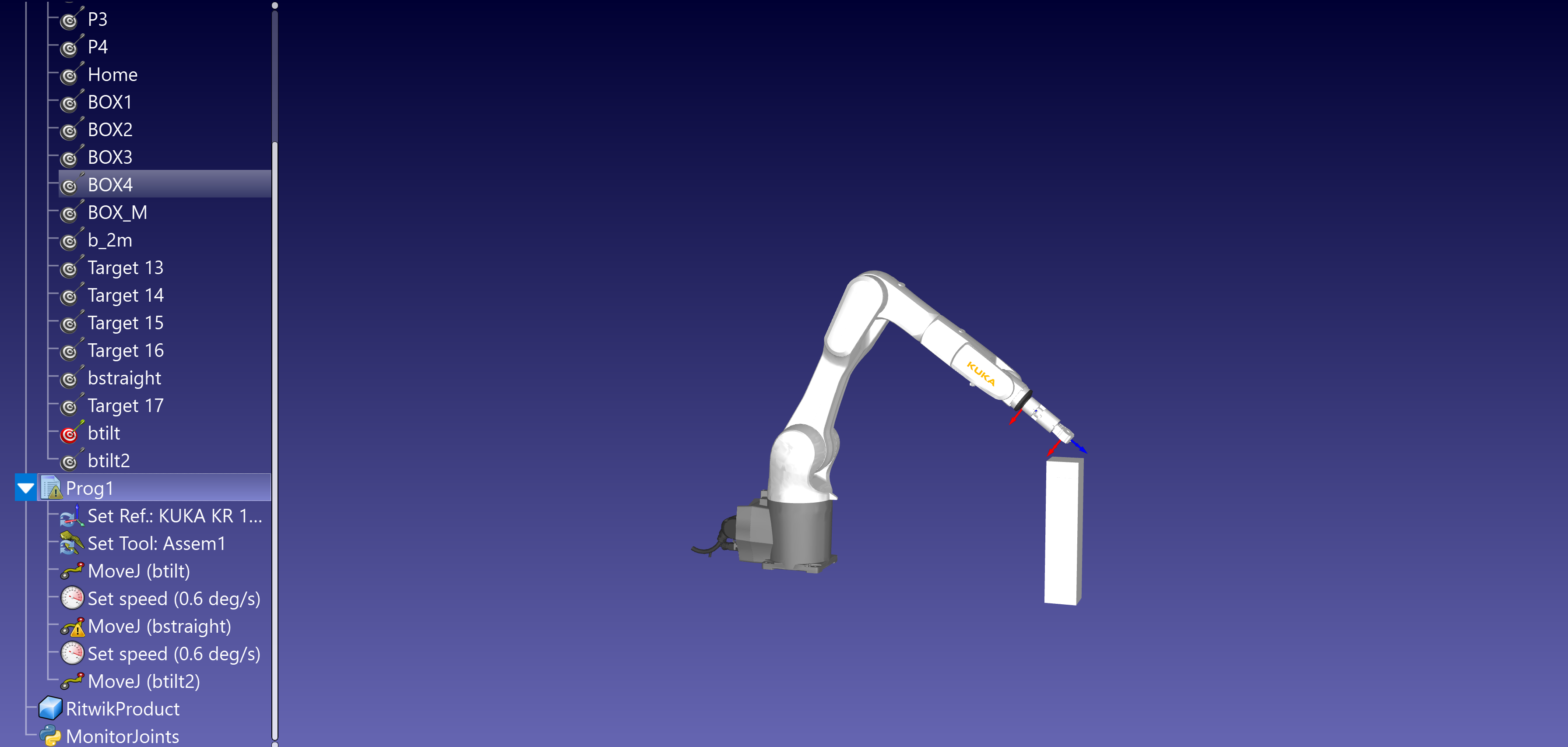

Thank you for your response Jeremy. I did as you asked, but how do I get the 4x4 matrix in terms of XYZ ABC?
will this values XYZ abc include my tool as well from the program, you can see from the attached image
03-02-2021, 09:11 PM
Hi Bluerain,
This function will do the conversion for you: https://robodk.com/doc/en/PythonAPI/robo...ose_2_KUKA There is no image attached. Jeremy
