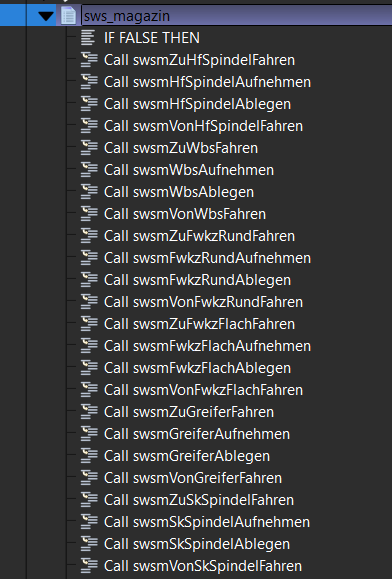

I want to use a program structure where I have one program per station. This program should consist of all approach and retract subprograms for this station. I want to be able to call this subprograms from other programs which I would code manually.
I did not find a better way to achieve this than to create a program where I call all the subprograms of the station and put an
IF FALSE THEN
ENDIF
around the calls so I don't accidentally execute the code:

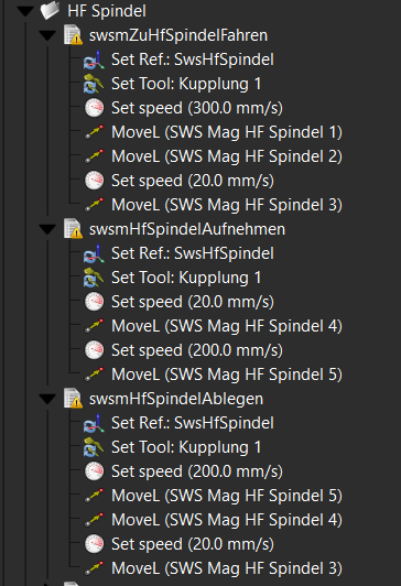

Each subprogram defines the reference frame and TCP:
But while generating the program with the post processor (a customized KRC4 DAT pp) RoboDK seems to be smart enough to recognize that it does not need to define the reference frame and TCP for each new subprogram when they didn't change between subprogram calls:

Unfortunately this is not the behavior that I need.
You can remove the automatic filter that applies to changing the tool and reference/base frames by following these steps:
  • Select Tools-Options
  • Select Program tab
  • Uncheck the option "Filter setting reference and tool frames", towards the bottom right.
(02-01-2023, 09:13 PM)Albert Wrote: You can remove the automatic filter that applies to changing the tool and reference/base frames by following these steps:
Oh... it's about the only option I didn't try. Thank you very much!
I have the same issue with the positions now. RoboDK does not create a movement to a position when it thinks, that the robot must be in that position anyway because of the prior call to another subprogram. Is there an option too?
Or maybe there is a better way to create station programs into a single program?
