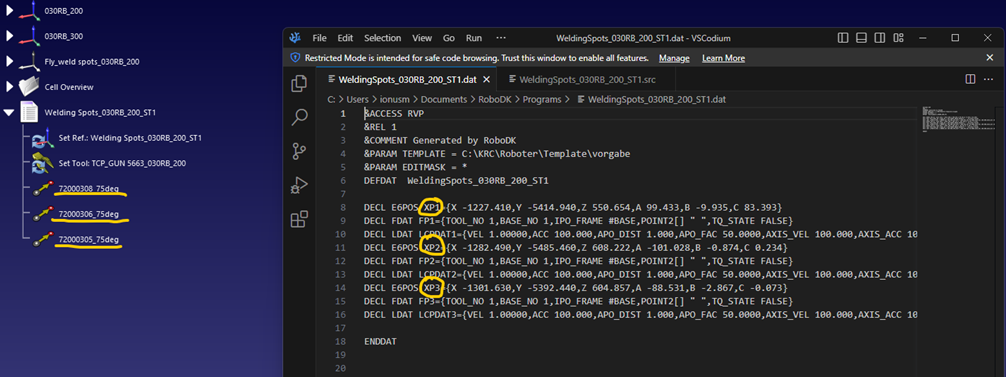

Hello, there is any way to have the same name of the location in the robot program and exported program?
Thanks!

You can customize generating movements to named targets using the target name in RoboDK for some robot controllers such as ABB IRC5 controllers.
However, it looks like you are using a KUKA robot with a DAT version of the KUKA post processor. It is better if you can contact us so we can customize the post processor for you: https://robodk.com/contact |
