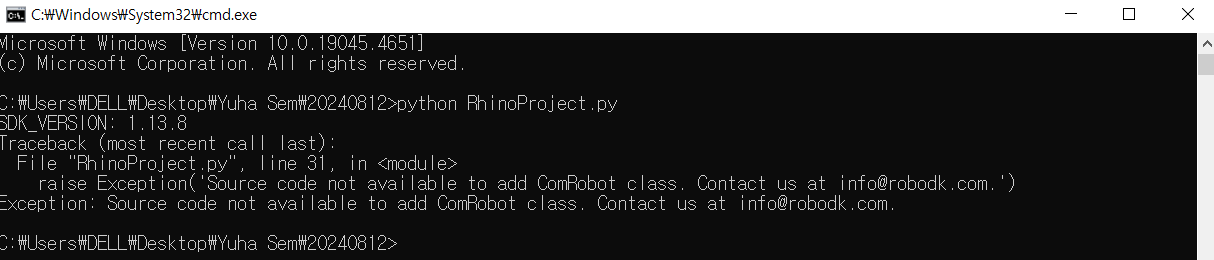

Finally, we ran the generated Python code. Some errors appear mentioning that the xArm is not in the path.
To solve this error we added the xArm library to all program paths and then ran it again.
The new error appeared shown in the screenshot mentioning to contact RoboDK.
Now we are writing to ask you for assistance in resolving this error.
If you need more details, please let me know.
Some post processors don't work well if you use the compiled version. You should contact us by email with this issue (mention this thread) so we can provide you with the correct uncomipled version of the post processor or driver:
