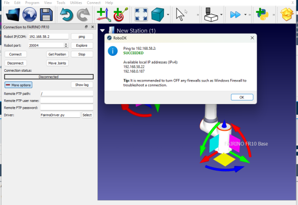

Good Afternoon Albert.
Im trying to use the Fairino Driver to connect RoboDk to my Fairino FR10.
My settings are:
Robot IP/COM: 192.168.58.2
Robot Port :20004
I succeeded with the ping, but when I tried to connect or get position, I got an error.
This is part of the log:
Driver for RoboDK 5.9.6.25622
Disconnected
Stopped
Starting robot driver: C:/RoboDK/api/robot/FairinoDriver.py
Using RoboDK RoboDK v5.9.6
Starting...
Unexpected error: File "C:\RoboDK\api\robot\FairinoDriver.py", line 14
Unexpected error: RDK_COMMANDS = {
Unexpected error: ^
Unexpected error: SyntaxError: '{' was never closed
Sending command...
Stopped
Driver FairinoDriver.py not connected
Disconnected
Stopped
Do you have any hint? bad port?
Have to install something more? Is something missing?
Thanks again.
Carlos Shinzato
#15
We noticed there is an issue with the Fairino driver with the current install.
You can delete this line 14 of your post processor in C:/RoboDK/api/robot/FairinoDriver.py so the driver works properly (the line where you see "RDK_COMMANDS = ...").
We'll fix this issue with the next release of RoboDK.
