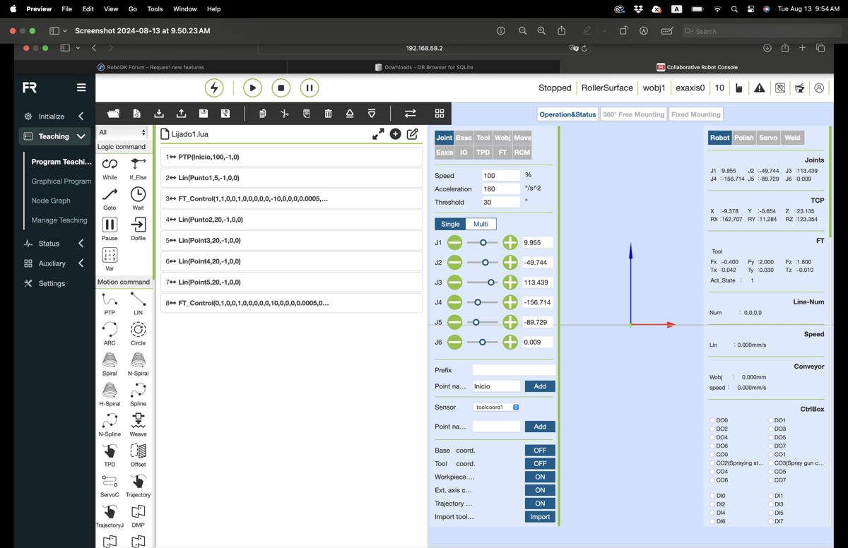

Sample of program with video
https://www.dropbox.com/scl/fi/0ut4d9nbh...5rq1u&dl=0
.tar   program_Lijado1.tar (Size: 60 KB / Downloads: 705)

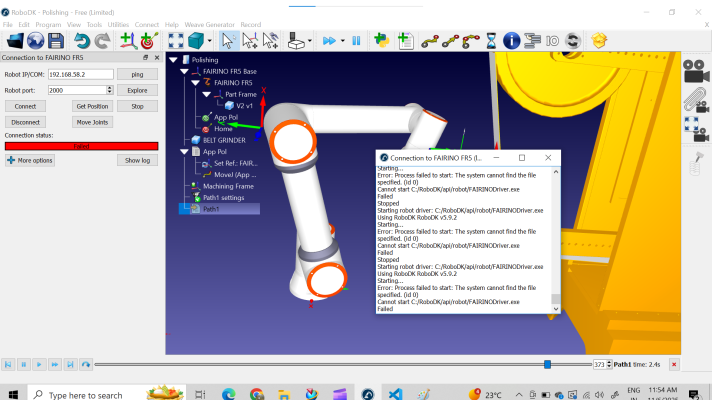

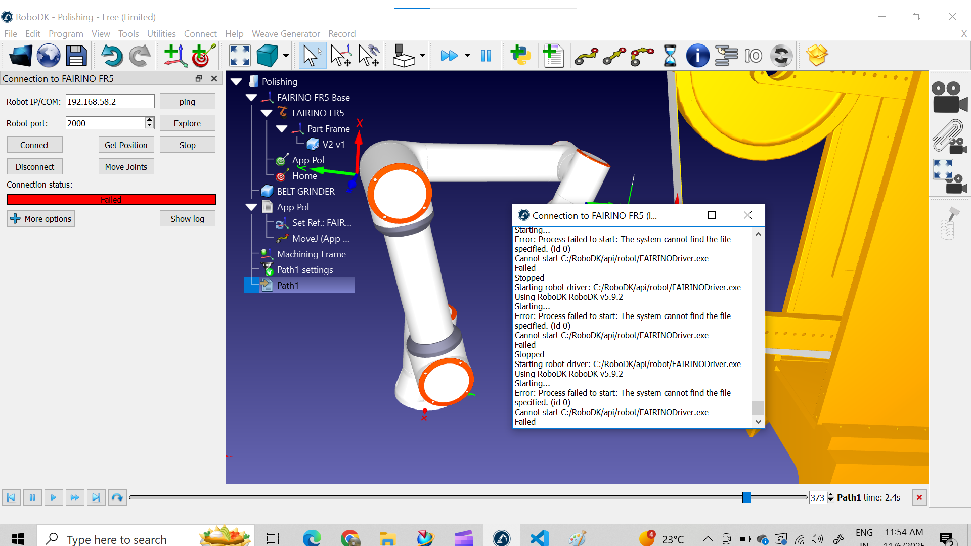

Hello Albert,
I hope you are doing well,
I am facing some problem while connecting Fairino FR5 with RoboDk. Can you please share updated driver and one small video on how to connect FR5 with Robodk.
Thanks
The procedure for using the Fairino driver in RoboDK is the same as for other drivers:
https://robodk.com/doc/en/Robot-Drivers.html#UseDriver
Please find the updated driver attached:
.rdkp   com_robodk_post_fairinodriver.rdkp (Size: 34.54 KB / Downloads: 528)
