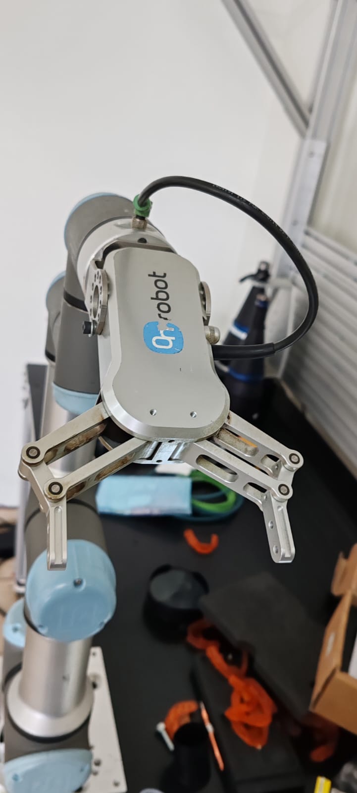

Hello, I'm interested in add to the library the Onrobot tool RG2.
I could import the step file and create the tool, but i want to make it also functional for the simulations like the robotiq 2F-85. Both tools have similar configurations, so the process should be quite similar.
I made other tools functional using the model mechanism option of the Utilities in RoboDK, but this one is not a regular 2 finger gripper.
Do anybody know some tutorial where I can found how to achive that?
I record a small video with the two grippers.
Thanks in advance
.mp4   2023-12-28 18-36-26.mp4 (Size: 472.12 KB / Downloads: 644)
