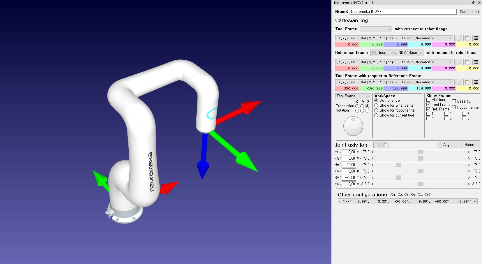

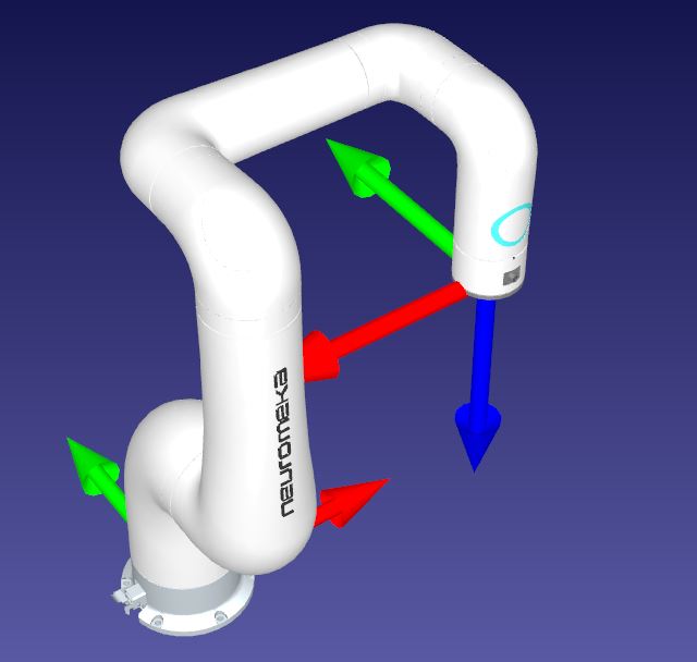

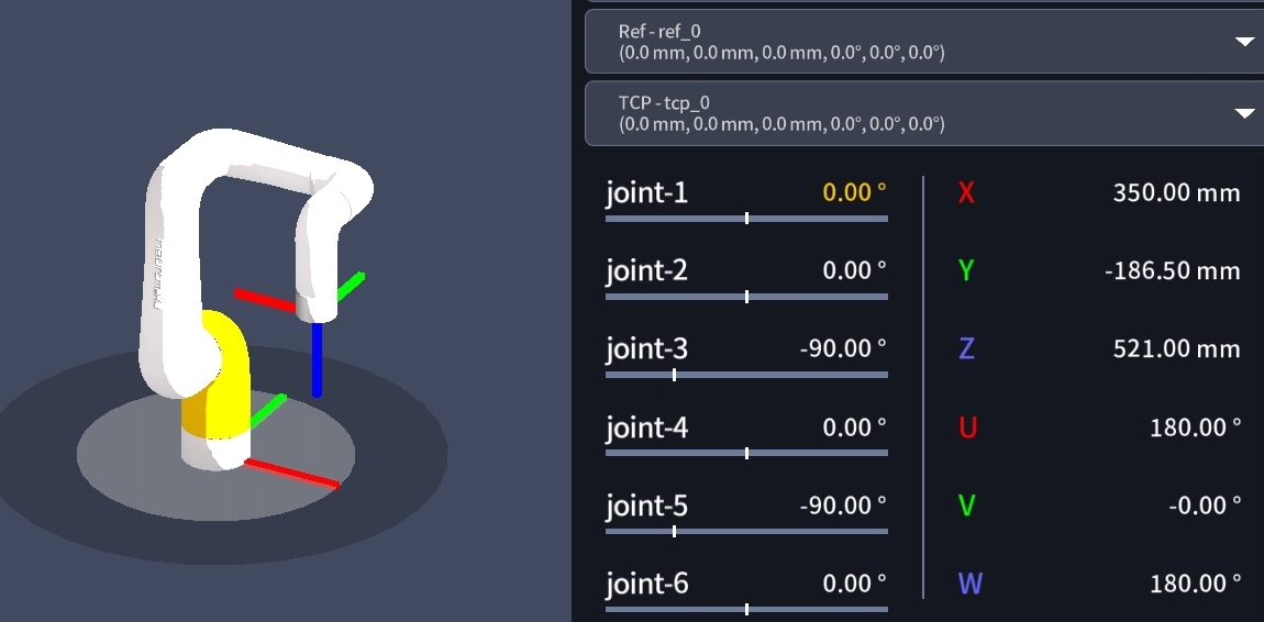

And i just found robot's basicTCP(Robot Flange) tilted
here's teach pendent screen

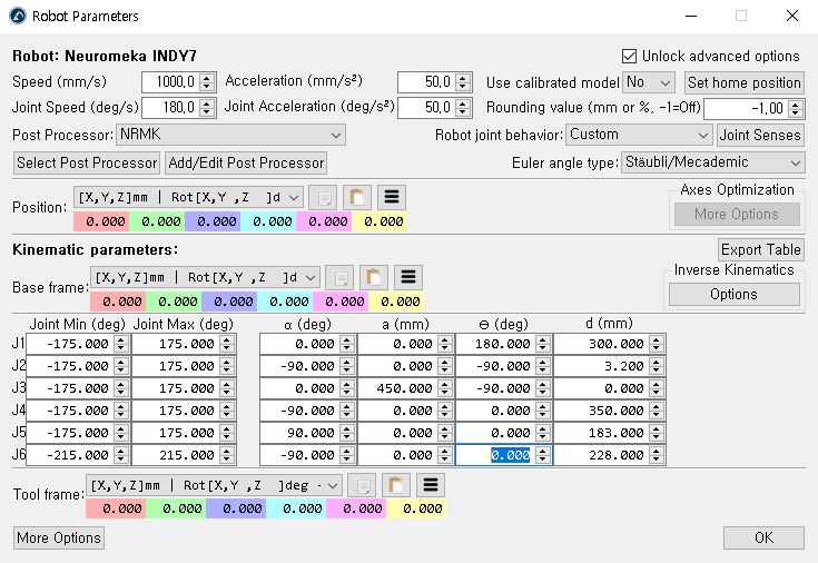

I've tried Robot parameters-Unlock advanced options-fix J6 degree θ
and after fix this robot doesn't move in cartesian jog

I've try the same solution
But this solution makes not allow to move in cartesian jog

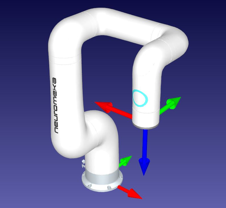

FIxed it!
Made new one to use invert joints.
changed
-invert joints
-fixed parameters
.robot   NRMK-Indy7.robot (Size: 256.64 KB / Downloads: 677)
