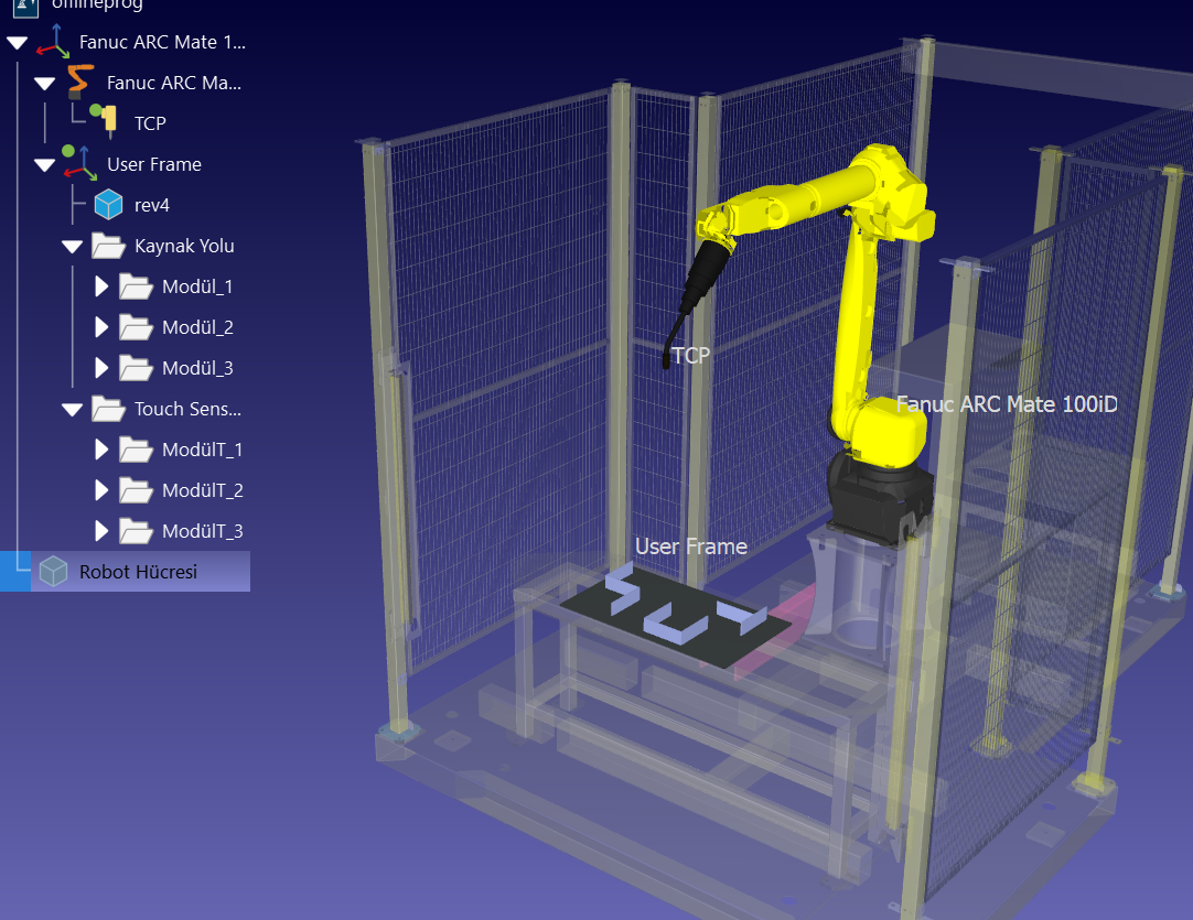

When the Python program is running, RoboDK slows down a lot because of the robot cell. I do not want to hide the cell completely. What I want is to get a view like the one in the image with Python.
I don't think we can help you better without your sample RoboDK project file.
What do you mean by semi realistic form?
(01-13-2025, 07:46 AM)yunuskr__ Wrote: Unfortunately, I cannot send you my project because it is a special work. How can I get a semi-realistic form as I indicated in the image? Is there a method for this?
In Robodk, when you turn off the visibility of an object and select that object while its visibility is off, you get a semi-transparent view. What I mean is that
You can change the color of objects in RoboDK by selecting Tools-Change color, and when you change the color you can also set the transparency for that object.
