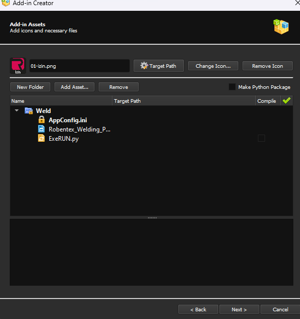

Hello, I created my own plugin in robodk and added it to the top menu, but I want to show my icon in the menu instead of text. I couldn't do it.

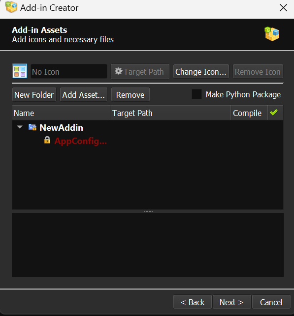

You can set the required icon during the add-in creation procedure in the Add-in Manager:
(08-21-2024, 08:04 AM)Sergei Wrote: You can set the required icon during the add-in creation procedure in the Add-in Manager:
My icon is selected in that section. I can see my icon in Addin Manager but it does not come to the top menu.
I solved the problem. When there is a .png file with the same name as the .py file, it automatically adds it to the menu with the logo.
