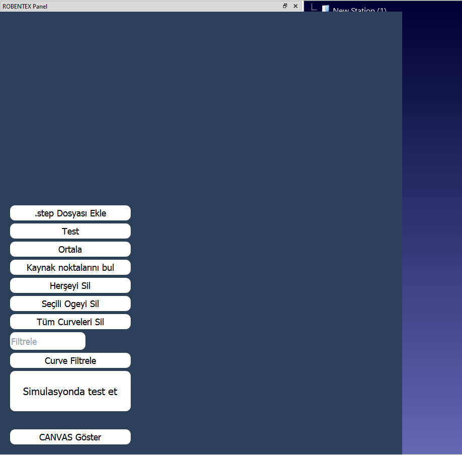

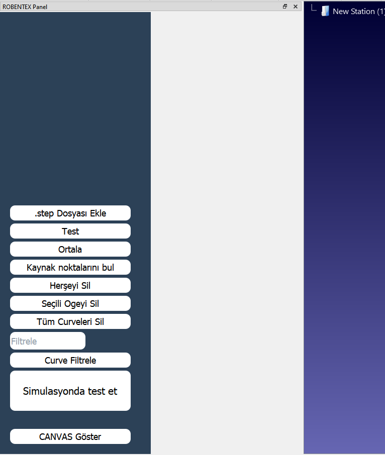

I embedded my interface I designed with PyQt5 into RoboDK. I set the size settings of the EmbedWindow to a button, but it doesn't work. How can we fix this?
Image(s)
EmbedWindow does not always work for current Windows sytems. It is better to not embed your custom user interfaces on Windows. A workardound is to use the Plugin Interface and Qt/C++ instead of Python. You can find more information about the RoboDK Plugin Interface here:
