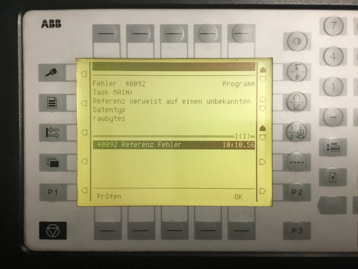

Hi. When I start the serial driver I get this error message...
03-10-2021, 09:31 PM
If you see this error, it won't be possible for you to use the RS232 or Ethernet driver.
I recommend you to program robots offline by generating mod/prg files. You should not have any issues with generating programs and loading them to your controller. |
