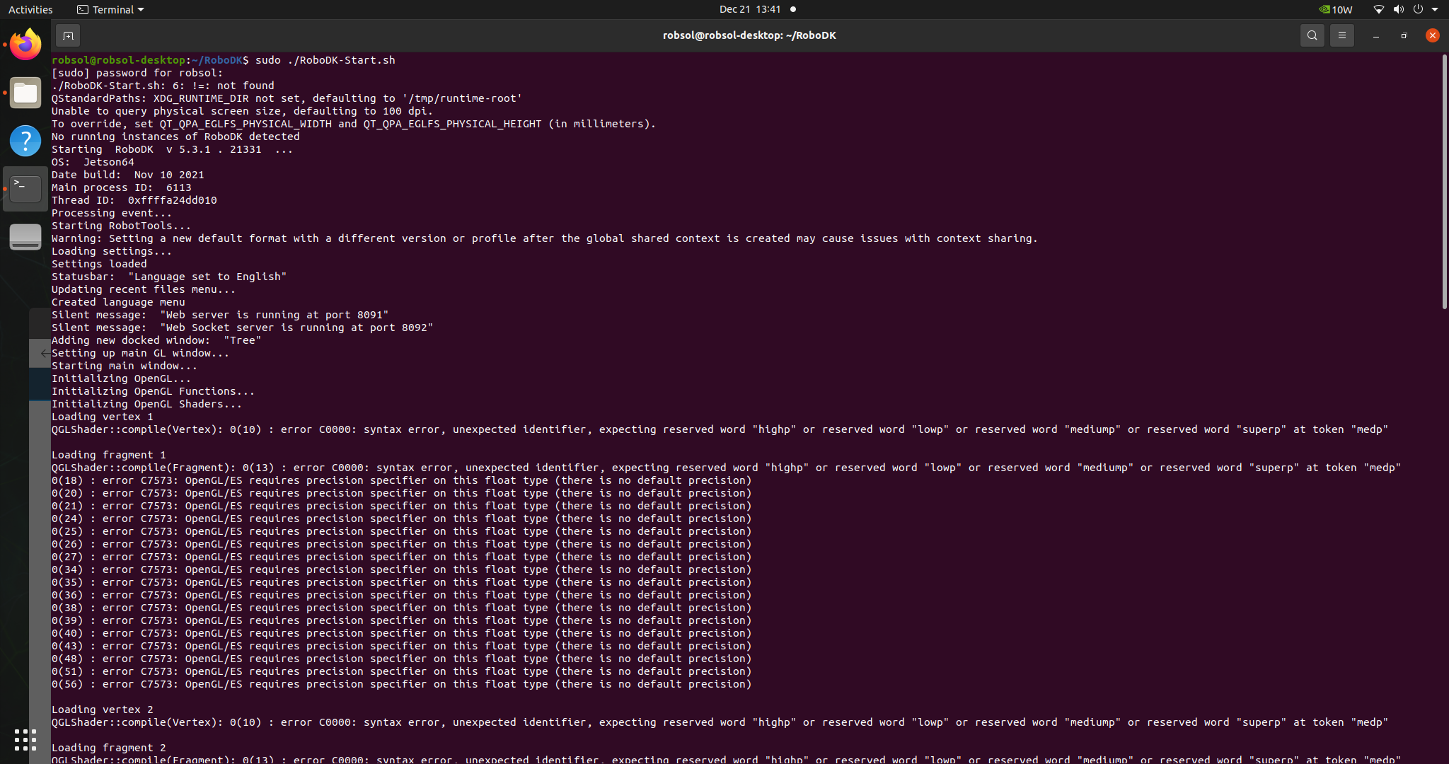

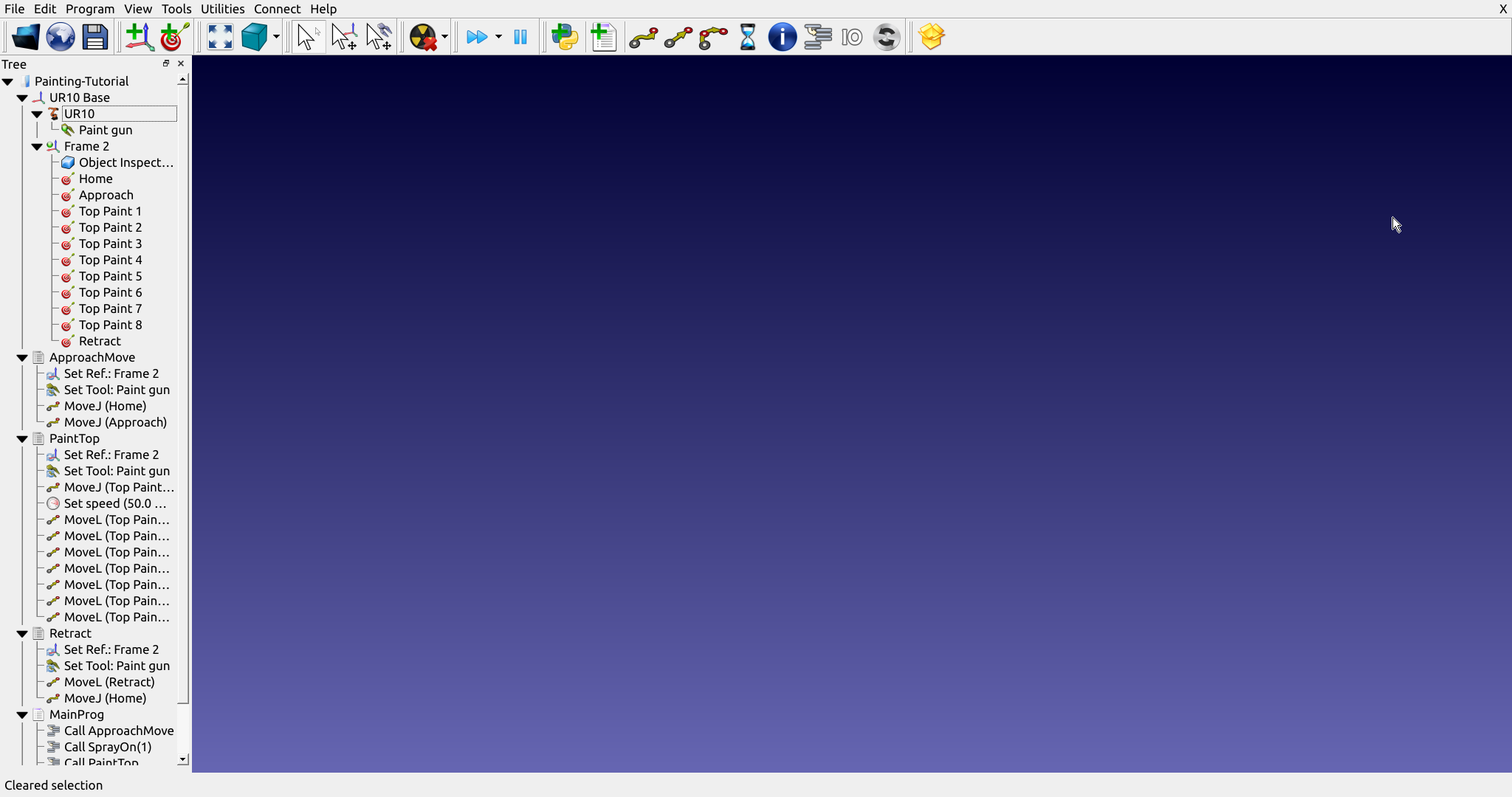

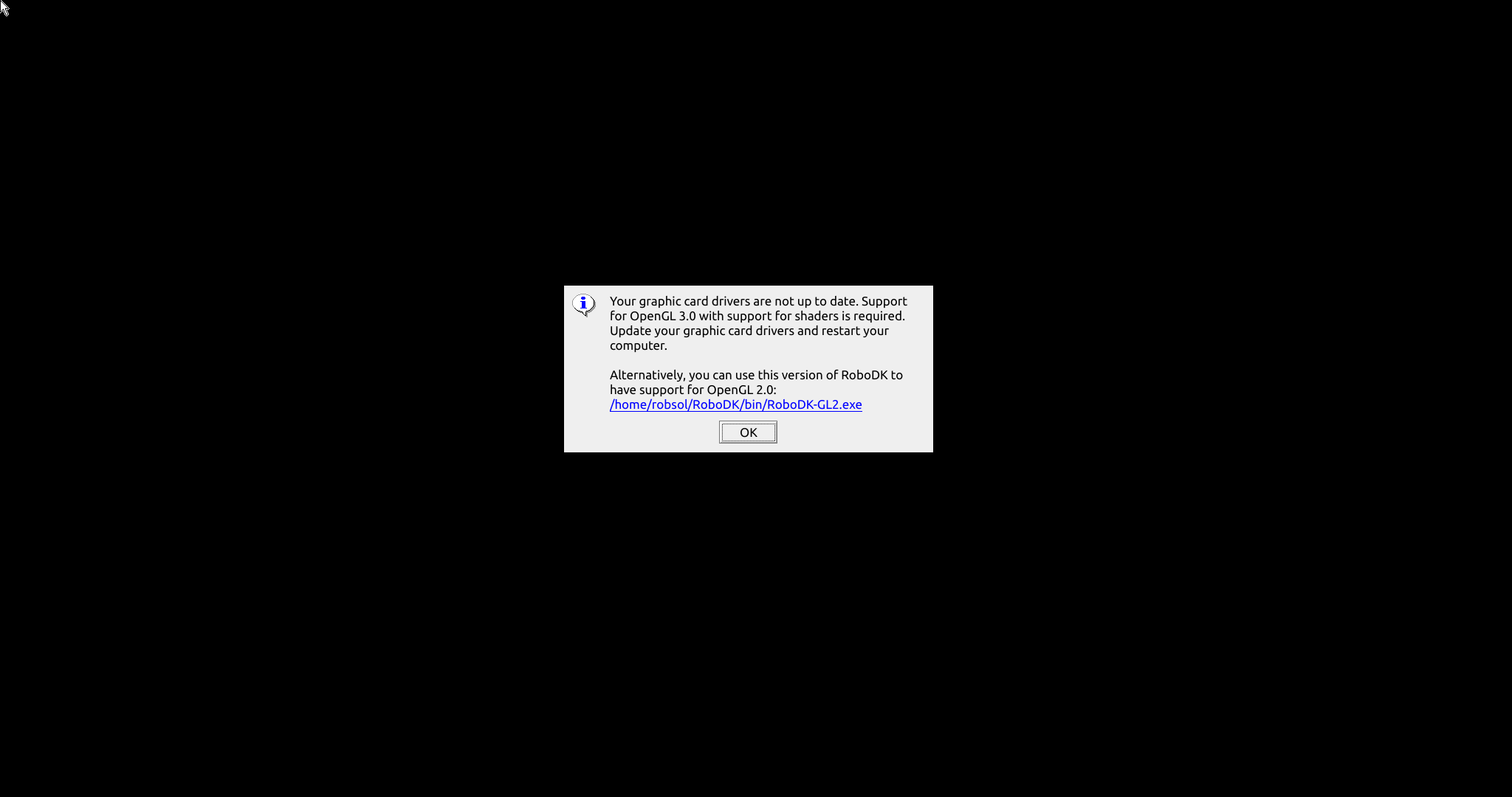

I tried that download as I have found it in an older post, but I get an error concerning OpenGL 3.0. You can see further details on the attached pictures. It looks like there is a problem with the OpenGL shaders. RoboDK opens and the menus are working, but there is no display of robots, parts, ets on the screen.
Screenshot from 2023-12-21 13-40-32.png    Screenshot from 2023-12-21 13-40-57.png    Screenshot from 2023-12-21 13-41-23.png

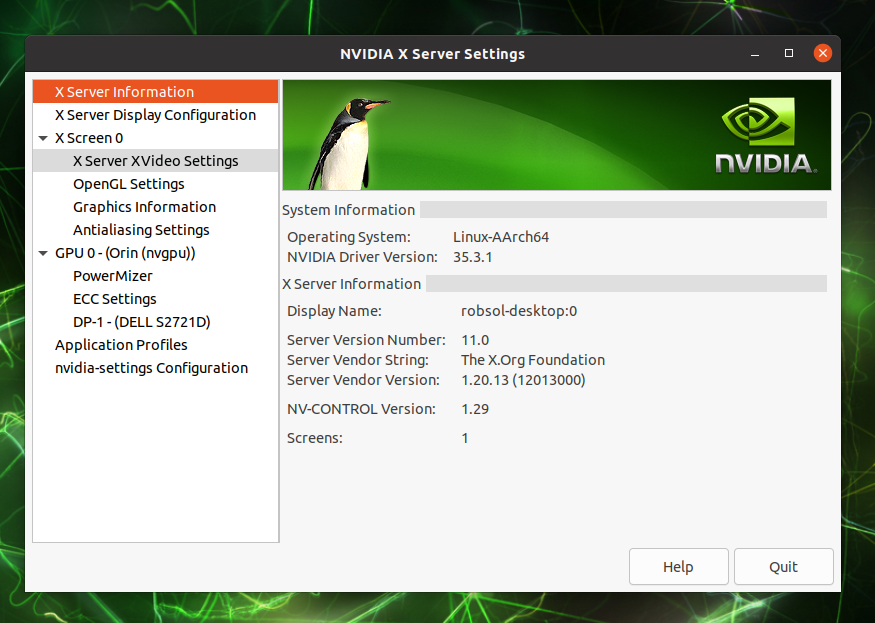

This issue is related to graphics card driver. Can you try updating your graphics card driver?
My graphic card driver is updated to most recent version for Jetson Orin Nano.

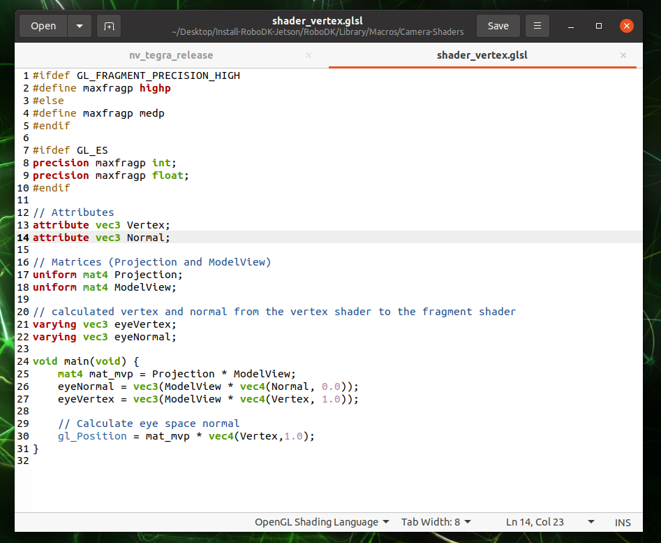

I found something in the .glsl files. (see attached picture) -> medp is used instead of mediump as the error i get in the terminal : QGLShader::compile(Vertex): 0(10) : error C0000: syntax error, unexpected identifier, expecting reserved word "highp" or reserved word "lowp" or reserved word "mediump" or reserved word "superp" at token "medp"
I tried modifying the .glsl files with mediump instead of medp, but I still get the same error.
